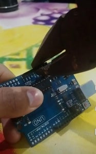

Step 1:
We can use players, use players to pull out the black cover of the header pins.

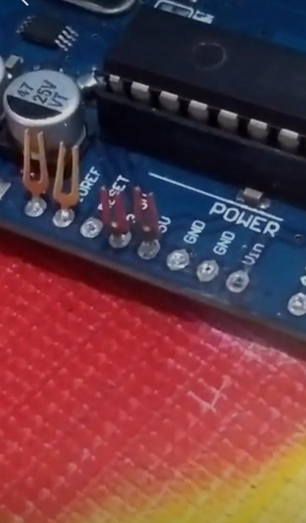

Step 2:
and you can see the bare pins.

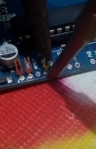

Step 3:
Now take your soldering iron and heat the solder from the back
Step 4:
Use needle-nose pliers to get a good grip on these pins and use your iron to remove the solder on the top,
and when the solder melts smoothly remove the pins.
Step 5:
use the soldering iron carefully,
if not careful it can permanently damage your board. That's it! and that's how you remove it.
