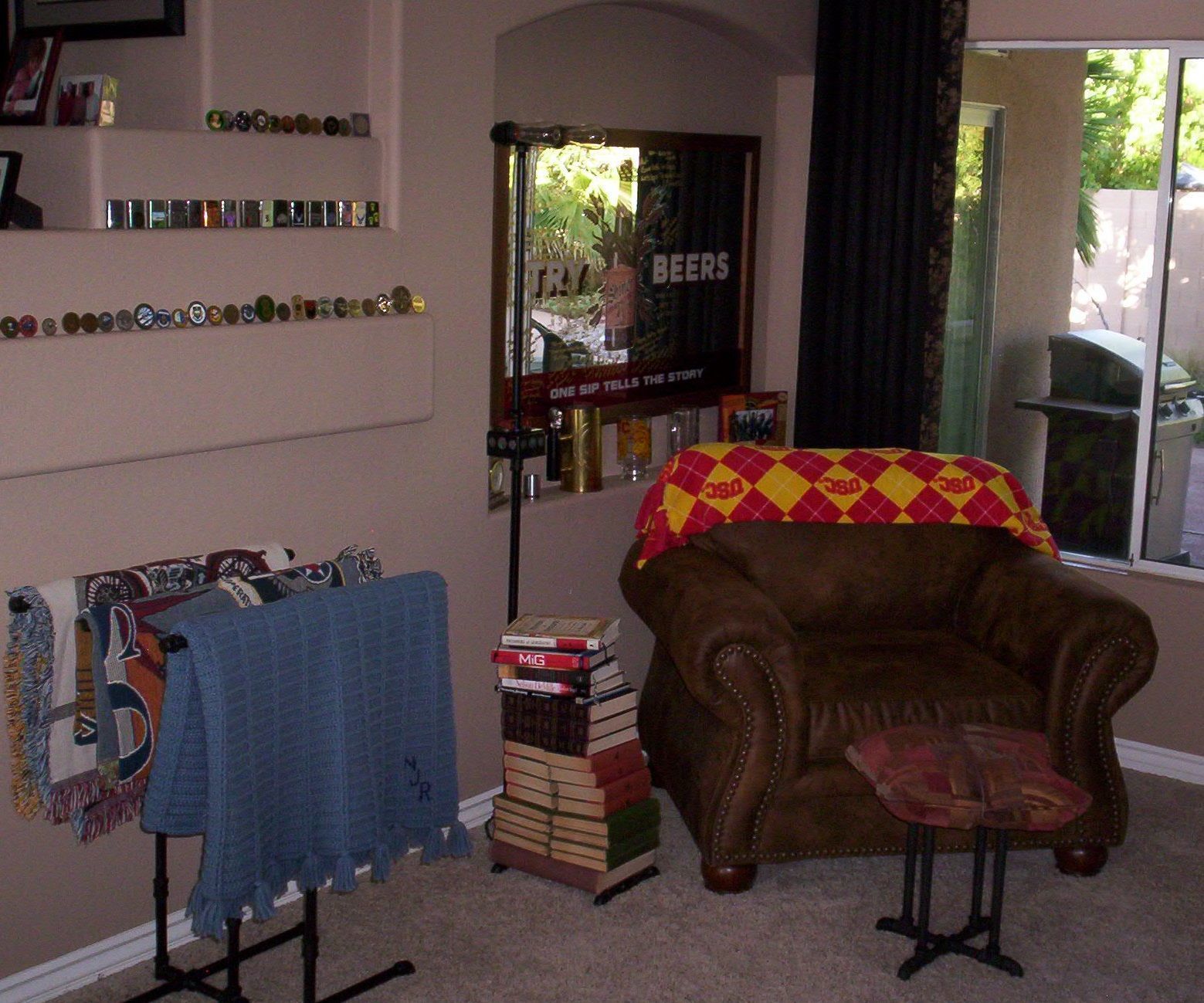

In her excellent class on how to write an ‘ible, JessyRatFink talks about design tools. However, she missed one (GASP!). I use MS PowerPoint (MSPP) for a LOT of my design work. I can import a picture, do minor color/contrast editing, resizing, overlaying, and a whole lot of other stuff. I designed the shelves in my bar (which you can see here) in MSPP. I’m pretty sure the program wasn’t designed to do that, but then again MS Paint wasn’t designed to develop floorplans for houses either (yes, I’ve done it, with good effect).
Using OsmanGazi’s design as my template, I had the rough dimensions I was aiming for. I marked those out on my wall with blue tape to make sure they were good. Then I took a picture of that to load into MSPP. My next step was to find a world map that I could use as my baseline. Google provided ample options, and I selected one, imported it into MSPP, resizing it and changing the brightness to fit my need. When I was satisfied, I started plotting locations (more on that in the next paragraph)—beginning with each of my homebases. Once the bases were located, I used MSPP’s straight line tool to draw lines from each base to a location to which I’d deployed. Each base was a phase of my life, so the lines from each base are color-coded (e.g. “When I lived in Alaska, I went here, here, and here—so these lines will all be yellow”).
