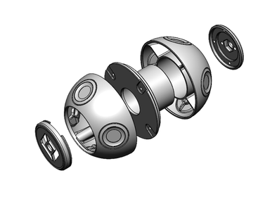

The Ghost only has three splitlines, which implies at most four parts:
  1. The front half.
  2. The back half.
  3. The front cap.
  4. The back cap.
The caps are flat instead of spherical. The caps are mostly identical to one another, and the halves are also mostly identical to one another. We could technically have more external parts, since this lamp is unlikely to exist as unshelled Just Ghost, but that means more seams than technically canon, and the perfectionist in me cannot abide by this. So let's start with the 4 core parts and start looking at our constraints:
  1. Swappable shells:
  2. Conceptually this is always solved with "magnets". Today is no different.
  3. The base Ghost has 8 little divets on its body, that conveniently line up with the 8 polyhedra that form the Generalist shell (it's almost like someone designed in that way). 8 also feels like a good number and gives us shell engagement in every direction, so let's stick with that.
  4. The divets and the curve of the shell also give us access to built-in clocking, which will be helpful for making sure that things don't spin around--two divets and the spherical curve of the Ghost will completely constraint a Shell placed on just those two divets.
  5. The divets are tangent to the surface of the Ghost sphere, which means we probably want to leave the Generalist pieces as 8 separate ones (rather than doing them in pairs or halves/4s).
  6. If there are magnets between the Ghost and its Shells, we'll need internal access to both of those pieces. The Ghost was going to need this anyway, and it's probably best practice to print the Generalist shell as a shelled surface (say that 10 times fast) to use less plastic, but this is important to keep in mind--we can button everything up at the end, but if we don't want the magnets to be visible at the end (we don't), we have to be able to put the magnets into the pieces at some point.
  7. Bulb access:
  8. I actually didn't list this as a requirement when I started, which is silly--let's add: "should be able to switch the light bulb without tools or disassembling everything" to the list of must-haves.
  9. Looking at the Ghost design, there's a few natural breakpoints: the front and back halves are pretty distinct. We could probably leave the back half fixed to the lamp gooseneck and have the front half uncouple, leaving the socket exposed. Seems simple enough.
  10. Wait, but--the rear half needs to be able to spin.
  11. Thinking this through, this is actually a terrible feature request. We could fix it with a slip ring, but:
  12. I do not want to implement a slip ring for a lamp that I dug out of a goodwill bin.
  13. Also, I do not want to have to keep replacing cheap slip rings in my lamp for a throwaway feature that no one asked for.
  14. So this means we should rethink some things! Let's look at some unspoken constraints that this feature is revealing:
  15. The socket should basically be hardwired to the gooseneck (and by extension, power), with no moving interfaces between it and mains.
  16. The lamp gooseneck interface is a single, hollow 5/16-18 threaded connection.
  17. Looking at the parts we have available to us, it seems clear that we need the rear half to rotate on something. The Ghost geometry is radially symmetric on the socket axis, so I think there's some potential there:
  18. The socket itself: technically feasible, and in the right area, and intrinsically I know the socket is ceramic and will probably outlast the prints, but it pains me to even consider using an electrical component as a mechanical wear surface.
  19. This probably leaves--a new 5th piece to serve as a shaft. We probably want something that's rigidly fixed to the lamp gooseneck--but we need the socket to be included on that, and the lamp gooseneck only has its own point of interface.
  20. We can get around this by fixing the socket to the rear cap, and then fixing the rear cap to the socket while pinky-promising not to pull the wires too tightly. I went back and re-specced the socket to find one that had through-holes that we could use (the BOM above is correct) for this purpose.
  21. This mystery 5th piece, a shaft, could just be the front half, since they need to be rigidly connected, but:
  22. We still need to access the inside surface of the front half to put magnets in the divets. We could do strategic keepouts, but:
  23. I'm 3D printing this, and it would be a pain to remove all that support.
  24. This all kind of works, in the sense that we should probably prototype some CAD and see how badly it goes, but now we've unanswered the bulb access question--under this solution, the front half is now rigidly connected to the socket via hardware.
  25. We could probably fix this with magnets, but at the same time I do want the front half<>shaft connection to be structural. If the magnets hit that sweet spot of weak enough to be removable, but strong enough to stay intact during operation, great; however, I still don't want to have to disassemble core structures of the lamp to change the lightbulb. This project is already deranged enough.
  26. We could consider using the front cap as a breakaway point--if the opening is just large enough for the bulb, we could remove the front cover and then delicately unscrew/remove the bulb for replacing.
  27. This is less ideal, and requires a bit more precision (and probably kills the punchline of several "how many X does it take to change a lightbulb" jokes), but it's better than slip rings, so let's go with that for now.
This line of thinking broadly leaves us with designing the following 5 parts:
  1. The front half
  2. This is mostly unchanged, but now will need some hidden/internal mounting features.
  3. The back half
  4. This is mostly unchanged, but will now need its own internal rotation axis.
  5. The shaft
  6. This is a new addition, and is hard-mounted to the front half.
  7. It also will have a concentric/rotation feature with the back half, and has a lip/bounding feature to prevent the back half from moving too far forward.
  8. The front cap.
  9. This was almost entirely aesthetic, but now provides the primary access for changing the light bulb. We'll probably want a bayonet feature, like a camera lens, or some other hidden but easily accessible removal feature.
  10. The rear cap.
  11. This mates to both the socket and the gooseneck
  12. This also mates to the shaft.
  13. This also has a lip/bounding feature to prevent the back half from moving too far backward.
All that work to add ... one extra piece? It doesn't seem that dramatic even spelled out like this, but we do have a much more firm idea of what we want to make now.

5 parts is a good number for a basis--this means we can probably keep everything in a single part file, rather than messing around with passing information back and forth between files. This is generally called multibody part design, and is useful when we want to be able to have a lot of linked information, such as keeping the front and back half the same size, or making sure that the hardware holes line up between the rear cap and the shaft.
I like to start with blocking out my major keepout zones--for example, we can't edit the circumference of the socket or the height of the lightbulb; ideally, we'll be building around them instead. I like to just block those areas out in CAD with funky-colored surfaces, to remind myself not to pass screws through the power cord or something later. I use the first sketch of the model to lay out the important keepouts, and also to set up some other useful heuristics via global variables, including:
  1. The typical thickness of the part (1.5mm--this is a bit smaller than usual, but I feel like the hemispherical shape of most of the parts will impart a lot of strength)
  2. The minimum thickness of the part (here, also 1.5mm)
  3. The dimensions of the socket
  4. The dimensions of the light bulb
  5. The areas I want to clear for wires
We can also easily start to set up a general sense of size now. When the light bulb and socket are fully assembled, their end-to-end length is about 80mm; we can circumscribe them and see that, accounting for part thickness, the overall diameter of the Ghost would be 94mm. This is a bit bigger than I'd been hoping, but it's not showstopping large, so let's proceed with that.
This one sketch is pretty dense, but it also lets us knock out the next four bodies pretty quickly, since they're just simple revolves off of the main sketch.
Step 3: Core Geometries and Rotation
Next, we'll want to add that support/spinning feature onto the front half, in a way that makes it possible to print later. I'm planing on doing this by splitting it into two pieces, so there's one half dome piece, and one hat-shaped piece that forms the rotation shaft. We'll want to add in some bosses for the screws, and drop some holes in there for our plastic inserts. 4 should be plenty for a piece of this size. We'll also start roughing out that plate and rotating surface. For aesthetic reasons, I've put the plate as straddling the split lines (this should help hide any light shining through across the front/back halves), and for clocking/extra stability, I've sunk the plate in a little.
Let's clean up the end caps a little bit. Both of them are in need of some 3D print clearances, and the front one is going to get a little quarter-turn lockout--this lets us swap lenses later (so we can have one front cap that's just a light diffuser, and one that's got the Ghost/Destiny logo and a light diffuser).
Turning to the back cap, this one is slightly more complicated--we'll want to give it some support structure to mate to the gooseneck, and we'll want to attach it to the central shaft and the socket. The first one will be solved with a hex cutout for an inset nut--we could thread the plastic, but this is way easier. The socket will get screwed in from the inside. We'll also drop in some through-holes to mate with the rotating shaft, Dropping some fillets on this cleans things up a little. I don't love that this has visible hardware, but the 4 screws here between the rear cap and the shaft are holding all the weight, so better safe than sorry. At this size we could definitely get away with 1-3 screws, but 4 at least feels reminiscent of the rest of the Ghost's geometry, so perhaps it'll look a little more intentional.
Step 4: Magnets and Booleans
The divets on the Ghost are pretty integral to its character design (it's. just a ball otherwise. so the bar isn't high), so adding these in helps a lot with the character, and we'll be using these magnet divets for all of our shells in the future. We can rough out a shape on the same plane as the main sketch for where we want the divet to occupy (this is the material we'll need to remove from the shell), and then another shape, also on that plane, for the divet itself (this is the material we'll add back to the shell).
We could technically do this with revolve cuts and then revolve extrudes, but the placement of the 8 divets means we need at least 4 axes of symmetry to perform that--which basically means 4 revolve cut/extrudes, which means that if we want to change these features later (which we will, it's prototype CAD), we'll need to edit a minimum of 8 features.
However, if we treat these changes as a pair of bodies, we can then rotate just move the completed add-body and subtract-body to the 8 locations we want--and we will only need to keep adding or editing those bodies for the changes to propagate.
Speaking of changes, we're going to start adding in little magnet holders--since the only force they'll be seeing is pulling on them outwards (through the shell), I'm planning on just press-fitting them into place on the inside, and using the compliance of the plastic to hold them in. I'll also throw in some vanity fillets and ribs for support, as well as a nice little lead-in chamfer to guide the magnet during placement.
We can also go in and add a few little revolved cuts to this body, and some seams. This doesn't really do anything mechanically, but adding the appearance of parting lines will add the appearance of complexity--for cosplay-adjacent things like this, especially in a sci-fi setting, it's crazy how quickly these details stack up (or get buried and never noticed).
We can then go ahead and drop in a circular pattern around the main axis, and a mirror pattern across the front/back, to get a feel for how the halves look. And we can also immediately place them in a different location--originally I had them on a 45 degree tilt, but it's pretty clear that that'll get cut off by the front and back caps.

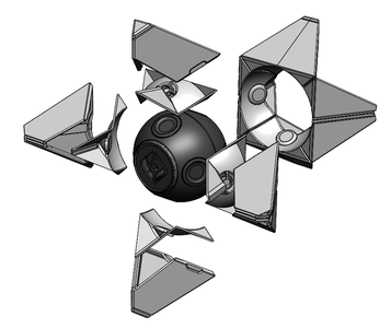

Step 6: The Generalist Shell
I have a hunch that getting the true geometry in Generalist shell is going to be a bit of a pain
I had no idea.
Edison once said he found 1001 ways not to make a light bulb. I found about 6 ways not to make this specific lampshade shape in CAD, so. Maybe there's hope for me yet! I'm skipping the first 6 attempts in the name of keeping this writeup from becoming a small novel.
This was, at its core, a surfacing question for me--the issue was just, how to make surfaces that were radially symmetric and also looked correct. A big realization for me was that the pieces actually form a triangle across the centerline, and the entire shape is basically two interlinked V's, which is how you can get them to form rigid lines in the circular pattern--if that doesn't make sense in words or pictures, don't worry, it took me forever to figure out (and may even be wrong. the joys of design).
From there, we can subtract out the Ghost main shell, and also add in our magnet boolean to make a piece that will mate with our sphere/divet combination. This is, in a literal and metaphorical sense, only half of the problem, but it's a huge improvement off of the first 6 or so attempts to make the shell.
Step 7: The Generalist Shell, Part 2
Remember ages ago, when we talked about needing to do something with the Generalist shell parts to make the magnet install locations accessible, at least for a little bit? The time has come. I decided to put the split lines on the face touching the sphere (aesthetically logical), and also extend them up to the frontward faces (less aesthetically logical). Keeping the splits on just the face touching the sphere would be the cleanest, but also leaves us about to interfere with the magnet, so it's a bit of a tradeoff. Since I'll be painting the seams shut after this, and the front split line will be under a ridge, hopefully we can keep this unobtrusive in post.
I work in halves for this section, mostly because it's going to be so fillet-heavy, and I hate going back and making sure I got all of the edges. I start by just shelling the entire solid piece, and then creating two trim surfaces offset from those internal faces. After cleaning up the trim surfaces, we can use them to cut the Generalist shell into our two parts. We can then drop the magnet boolean back in and add in some chamfers/fillets for lead-in.
Since there are 8 of these and we want them to look the same, we'll want to put a little lip/groove feature in for alignment. SolidWorks's in-built function for this really hated the shape I was making it offset (understandable), and it wasn't like I was going to brag about this CAD to anyone, so I ended up brute-forcing this via some Move Faces and trims (CAD professionals hate this one trick). A few trims/offsets/fillets later, and we've got a fairly serviceable base geometry here. We can then mirror both pieces to give him a cute little hat (important).
Step 8: The Generalist Shell, Part 3
It's not worth thinking about how the Ladylike shell is way cuter and is probably going to be used all of the time, because it's time to make tiny detail differences in the Generalist shell pieces to make it recognizable--the little orange tops and black sidebars. The feature tree for this section is about as long as the previous two steps combined, demonstrating the 80/20 rule in full force.
We'll start by patterning the completed two-piece fin portion over 90 degrees. The top and bottom fins are the same, and the left and right fins are the same (and the front is the mirror of the back), so we can get away with just four total unique parts. The notch on the top fins is done pretty quickly with a cut/extrude to reform the wall lower, and then we can drop a little seam on it to make it look like a distinct part.
The side fins are similar--the notches ended up landing a little deeper into the part. We'll then want to basically cut the whole thing in half down the centerline so we can start to rough in those sidebars. For some reason, sweeping really did not work here, so I ended up resorting to extruding up, chamfering on the centerline, and then mirroring. So much of CAD really just feels like tricking the software into doing the things it told you it couldn't do. We go in and drop a few cuts to remove extra material, merge the relevant bodies back together again, and drop in some vanity fillets (we are at 66 of those so far, lucky number).
Then, we can re-merge in the magnet booleans, unhide all of those features, and slow our computer processing to 2fps by patterning everything around--and hey, that looks really good, actually! Sure, we could've gotten this on freecad in about 90 seconds, but it wouldn't have had all of the dumb little screws and hidden complexity, and it wouldn't have been as fun. 30 more fillets later and we've got something pretty respectable looking on our hands.

The rest of this project is pretty simple--we've already wired up the main Ghost body, so it's mostly painting and post-processing, which I admittedly didn't document very well.
For the Ghost body, I hit everything with a base silver spraypaint coat, and then sandpapered/cut away at the paint in certain places to give it a bit of a weathered look. I used black watercolors to catch into the sandpapered/weathered sections--I applied them with a wet paper towel, let it sit for a bit, and then wiped it off, which left the grooves darker and helped them pop more. I also put a tiny little alignment dot on the lenses so that it'd be easier to locate the quarter-turn features--not canon compliant, but very helpful.
For the Generalist body, I inserted the magnets, glued the whole thing shut, and then sanded the parts forever because I "didn't think that the layer height would be visible". I should've sanded more--I ended up having to try to cover this up in the painting step, and I think it made the whole thing look a little blockier than I would've liked. I left this section unweathered (I liked the idea that the shells are nice and clean), but added in black and yellow on the notches and little sidebars.
For the Ladylike body, I painted the inner liners black and inserted the magnets. I painted the outer liners red, let that dry, put in the little spots with black, and then applied some glittery watercolor paint on top of that, let that dry, applied a clear coat, and then reapplied the watercolor/clear coat--at the very end of a scope-creep ridden project, this was a really terrible place to experiment new techniques, but I really liked how it gave the paint a sense of depth.
