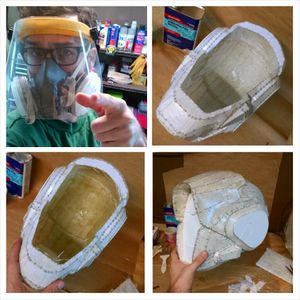

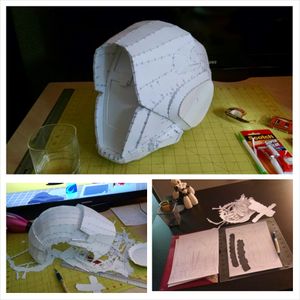

  1. Pepakura- The paper templates were printed on cardstock, cut out with an exacto, and painstakingly glued together tab-by-tab. Pepakura is extremely accessible and easy to grasp. However, it takes time, patience and a steady hand to get right. Keeping things symmetrical is paramount.Take you time when implementing this building method, and it will make life much easier in the end.
  2. Fiberglass- Once the paper model was together, I hardened it with a layer of fiberglass resin painted directly on the paper. This is done in sections to ensure the model does not collapse while wet with resin. Once the paper has all been hardened, a layer of fiberglass mat and resin is added to the inside of the helmet to bring it to full strength.

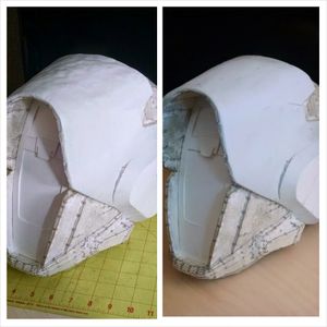

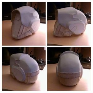

  3. Filler- The hardened helmet still has all of the geometry of the pepakura model, which is to say, it needs some help to bring it up to high rez, and eliminate the undesirable polygonal shapes. Pepakura is somewhat low-poly. To counteract this, filler is applied to the exterior to better define the shape and detail. Most of the time bondo is used, but I chose to use apoxie-sculpt instead. It is less noxious, has a nice long working time, and holds great detail. The down side is extra weight, and expense. The extra cost was worth it to me, and I planned on molding the helmet ,so weight was of little importance on the master. So add filler, sand, refine, over and over and over and over... until you have the master perfected
  4. Add Details- With your helmet all smooth. Now comes the time to cut in all of the small missing details. Things like seam lines, bolt.rivet holes, etc can be dremeled or files into the surface of the filler.
  5. Primer- With everything as it should be, I like to paint the helmet in a uniform color. If any blemishes or low spots remain, this should make them more obvious.

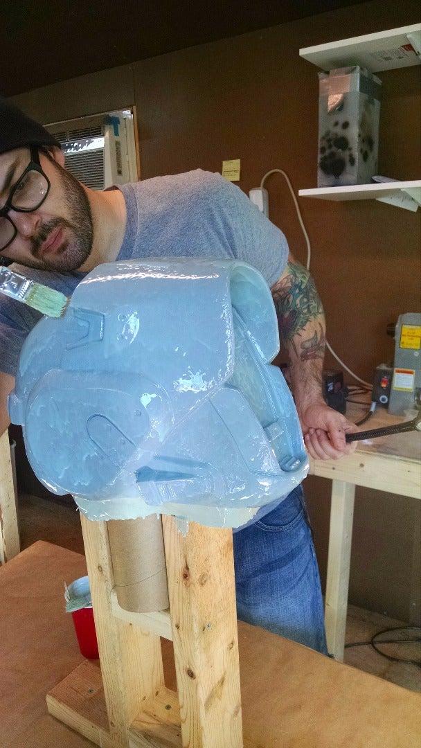

With the master finalized, its it time for molding and casting. This will allow us to create a lightweight, wearable plastic copy of the helmet we made. To do this, we need silicone for the jacket mold, and a materials for the rigid mother mold. I am using rebound 40 silicone rubber for the jacket mold, and plasti-paste 2 for the mother mold.
This is a long process, So I made a time-lapse video of the molding process. Enjoy:My Warlock Helmet Video
Casting:
Once the mold was completed, and had time to cure, I popped out the master. Which was completely unharmed by the way. It's a good idea to keep the master, just in case you need to mold it again.
Casting is as easy as pouring liquid resin into the hollow mold, and rotating it slowly until it starts to harden. Then, pour in a bit more, and do it again. I am using 65D resin by smooth on. Take special care to coat everything evenly, and not to let any sections get overly thick. This takes some practice. The good news is you can always try again if you mess up.

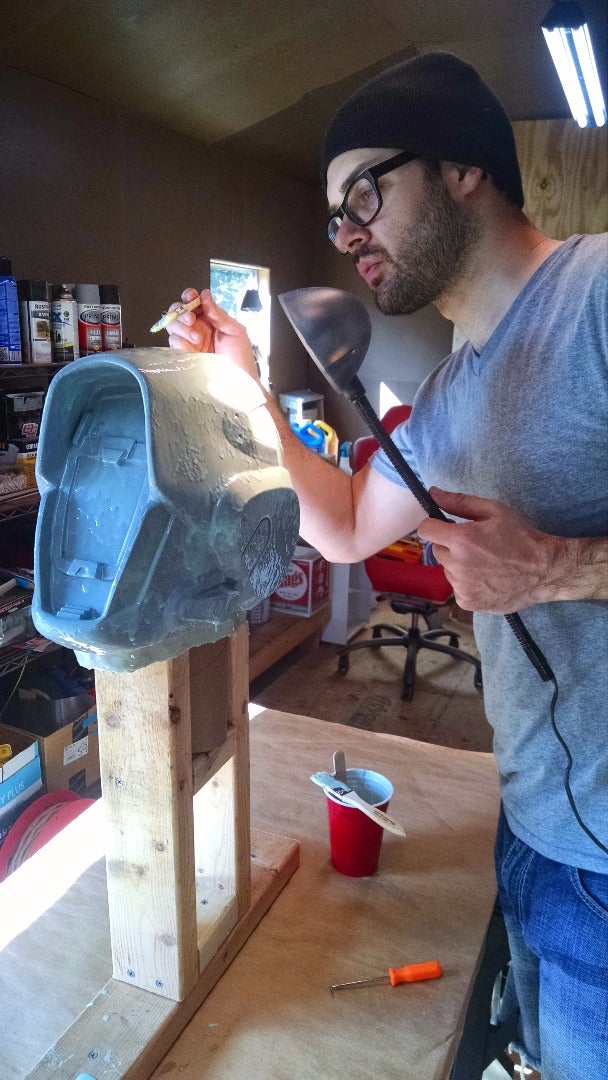

So we have a nice cast out of the mold, now it's time to trim the helmet's rough edges off and throw some paint on it. I started with a gray primer, then a silver base. After that, comes masking to separate the silver areas form the ones I wanted yellow.
I wanted the helmet to have a lot of weathering and chipped paint. So before the yellow can go on, I painted some toothpaste onto edges and high spots. Where the toothpaste goes, silver will show through. After the toothpaste, comes a coat of light yellow. On top of that a more orange-yellow hue is applied with an airbrush. This gives the helmet some nice age and dimension. The masking was then removed and further airbrushing was done to the silver portion of the helmet. There I added dark grays and blacks to the crevices.
Once the airbrushing dry, I applied a brown wash to the entire helmet to give it that Mars space helmet vibe.
Finally a tinted visor was installed to fill the opening in the front of the helmet and allow visibility.
