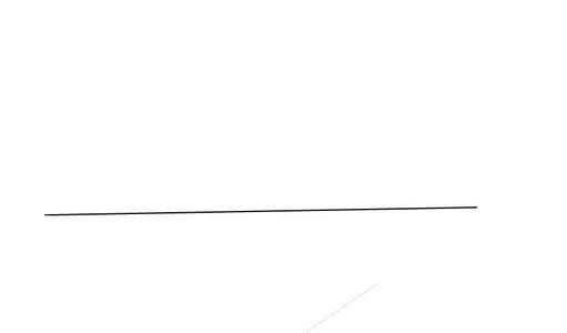

First, draw a horizontal line. I drew mine in chalk on the concrete floor so I had room for the apex.
Step 2:
Next, draw a perpendicular line in the center of the horizontal line.
Step 3:

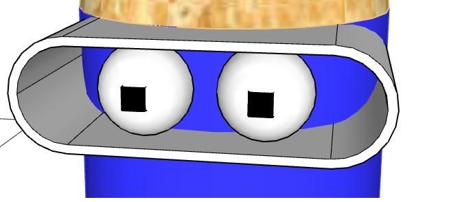

Cut out and roll the cylinder for the head. Mine was about 160mm diameter so final size will be 200 x 502mm. I just but joined mine and pop riveted a strip on the inside.
Step 12:

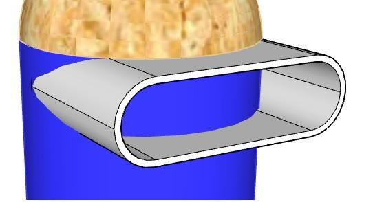

This is the eye socket. I made an oval form from wood at about 150mm x 50mm and clamped the heated plastic on this until it cooled and added a strip on the inside bottom and pop riveted this together.
Step 13:
Join more wooden pieces together and turn a half circle for the top of the head.
Step 14:
I found some foam balls at the cheap shop and cut one in half for the eyes. Anything that fits will do.

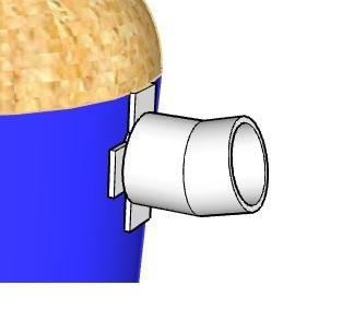

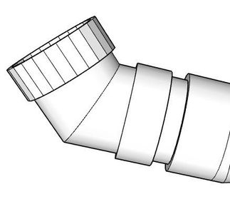

Cut a piece of 50mm pvc about 100mm long and cut and heat some strips on one end to attach to the body for the arms.
Step 16:
Attach 15 degree elbow.
Step 17:
Attach 45 degree elbow
Step 18:
Attach 200mm arm.
Step 19:
Attach 90 to 50mm reducer
Step 20:
Add 90mm endcap.
Step 21:
Attach 370mm legs. You can bow these a little.

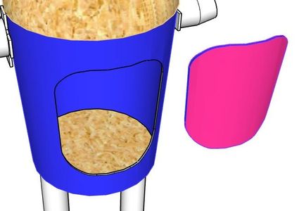

Step 22:

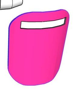

Work out your door shape. Attach some wood strips inside the body before you cut it out to hold the shape.
Step 23:
Cut a mail slot. All that's left is attach some hinges and a lock.
