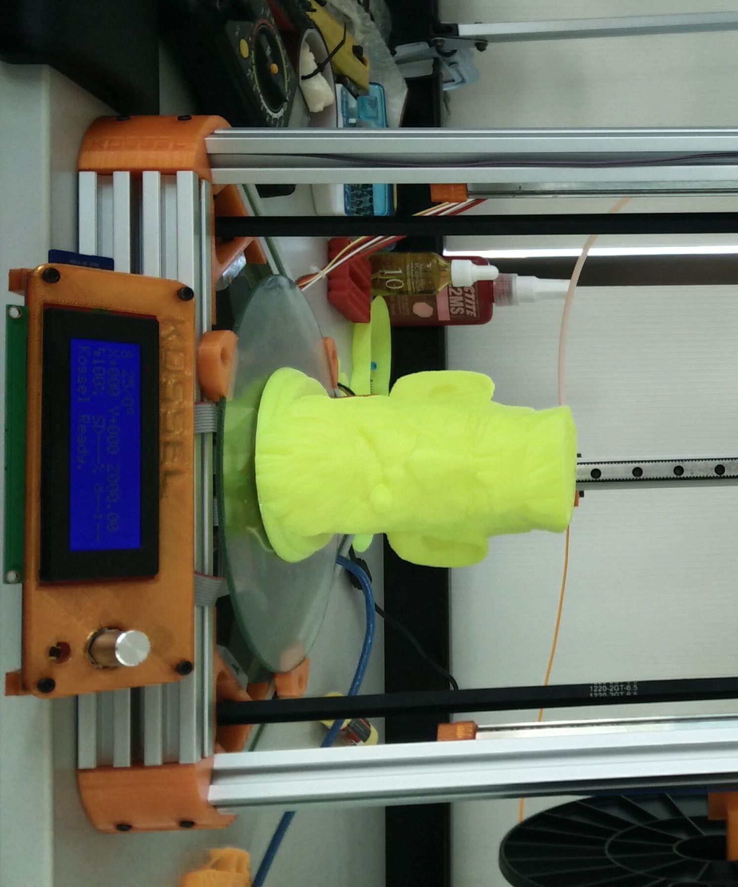

Step 1: Chapter 0 - Mini Kossel Kit Introduction
The Mini Kossel is the latest delta robot printer from Johann Rocholl, the designer of the original Rostock delta. It is an innovative and elegantly simple design featuring a small number of parts and easy assembly, with auto-bed-leveling to simplify calibration and keep it in tune.
The version 2 of the kit above has the following new features:
  • NEW: Pre-Configured Rich Cattel Version of Marlin Firmware with fully automatic Autocalibration!
  • Simplified Design, with fewer parts needed
  • Max. printvolume of up to 10,000cm3
  • Improved MkV J-Head Hot End
  • Print Speed: at least 60mm/s (max speed of up to 140mm/s)
  • Larger Print Bed: 190 instead of 170mm!
  • Dimensions of Printer: ca. 300 x 630mm
  • Smaller Power Supply
  • The set now includes all parts, i.e. you don't need to purchase anything in addition
  • Ballbearing side rails
  • Closed Belts
  • Shorter delivery times
  • Updated Instructions
  • All plugs are already preinstalled. No soldering necessary!
The kit features everything that you need for a successful assembly of a Mini Kossel 3D Delta Printer, inlcluding Arduino/Ramps electronics, LCD display etc:

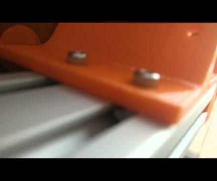

205 Fit extrusions to brackets
Insert 2 capscrews with washers through the 2 bottom holes and very loosely fit 2 t-slot nuts. Note that the screw head is facing the motor (order: cap screw, plastic bracket, nut, aluminium extrusion).
Slide an extrusion onto the 2 nuts. You may find it helpful to use a pair of tweezers or needle-nose pliers to rotate the nuts into alignment. Very loosely screwed on nuts makes this easier.
Slide the extrusion tightly up against the plastic and tighten the nuts just enough to stop it coming off. They will be tightened fully later, after the whole base is assembled.
Repeat the procedure with the top extrusion…
and with the other 2 brackets.
