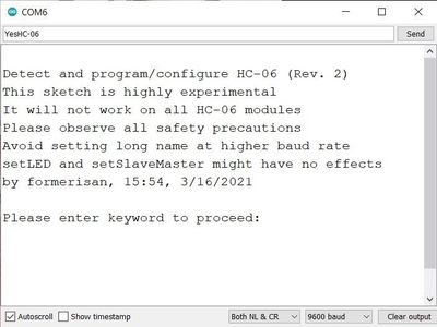

Step 3: The Greeting Screen and Some Observed Issues
The Greeting Screen displays very important information, including a list of observed issues during the testing of HC-06 modules on hand:
1. On setting module name, HC-06 had problem with 15 characters or more @baud rates 38400 and higher
2. Setting LED On/Off does not seem to have any effect. The research indicates that it might work on HC-06s with an extra blue LED on board.
3. Setting Slave/Master mode does not make any difference. The official HC-06 is a slave module. There are non-official HC-06s claiming to cover both modes. The sketch might work out with these modules.
Since the LED On/Off and Slave/Master mode commands were included in the official manual, a decision was made to go ahead with the implementation.
Step 4: Enter Keyword to Get Past Greeting Screen
The greeting screen requires the right keyword for the operation to start.
In the text box on top, please enter "YesHC-06" then click the Send button on the right.
The Configurator will now start to search for a valid HC-06.

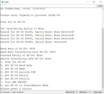

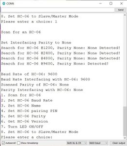

Step 5: Initial Search for a Valid HC-06 Module, Then the Main Menu
After passing the greeting screen, the screen will now display the initial search for a valid HC-06.
The search will cover all 3 parity setting, starting from None, then Even, then Odd. For the testing baud rates, it will start from the lowest baud rate(1200) all the way to the top(115200). The search will end only when a valid HC-06 is discovered.
In the first snapshot, a valid HC-06 was discovered running at 9600 baud, no parity. The second snapshot shows the result of another valid HC-06 with baud rate 9600, even parity.
Once an HC-06 is discovered, the main menu will now show up, display 8 available choices.
Step 6: Choice #1: Scan for HC-06
Enter "1" then click the Send button will cause the Configurator to enter and execute choice #1: Scan for HC-06.
This choice has the exact same effect as the initial search described above.
Again, the search will end only when a valid HC-06 is discovered.

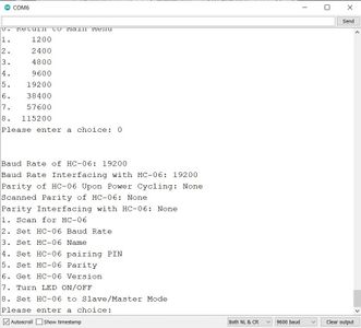

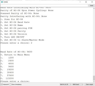

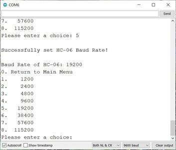

Step 7: Choice #2: Set HC-06 Baud Rate
Enter "2" then click the Send button will cause the Configurator to enter choice #2: Set HC-06 Baud Rate.
1. The configurator will display the "Set Baud Rate" submenu once choice #2 was selected.
2. Once the desired baud rate was selected, the Configurator will return with the execution result, as indicated on the second snapshot. (for example, select 5 from the submenu to change baud rate to 19200)
3. After the change was made successfully, the HC-06 and the Configurator would both change their operating baud rate right away.
4. In addition, the Configurator would remain in the submenu until a "0" was received to return to the main menu.
Step 8: Leaving the Set Baud Rate Submenu
The Configurator will stay in Set Baud rate submenu until the choice "0" is received.

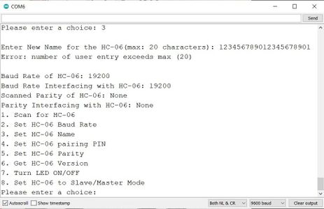

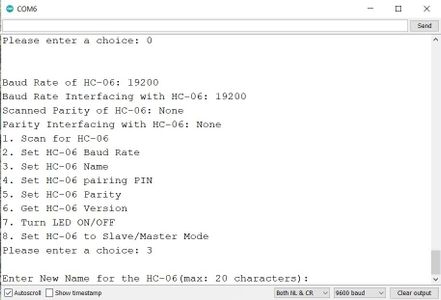

Step 9: Choice #3: Set HC-06 Name
Enter "3" then click the Send button will cause the Configurator to enter choice #3: Set HC-06 Name.
Enter the desired new name for HC-06 in the text box, "HC-06 Upstairs" in the example.
Step 10: Results of Setting Name
The snapshot shows a successful execution of setting name.
If successful, a message will be displayed. The operation will then return to the main menu
If failed, a message will be displayed and the HC-06's name would not change. The operation will then return to the main menu.

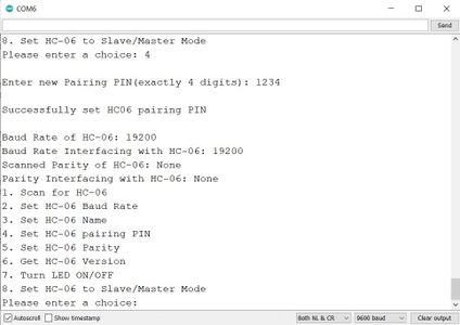

Step 11: Choice #4: Set HC-06 Pairing PIN
Enter "4" then click the Send button will cause the Configurator to enter choice #4: Set HC-06 pairing PIN.
The valid PIN contains exactly 4 digits (0 to 9)
If successful, a message will be displayed. The operation will then return to the main menu.
If failed, a message will be displayed and the HC-06's PIN would not change. The operation will then return to the main menu.

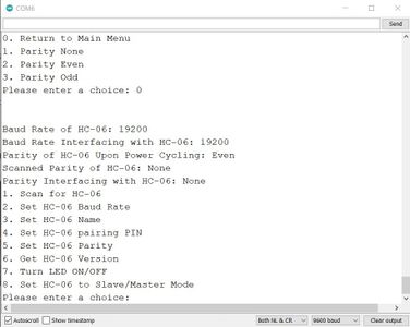

Step 12: Choice #5: Set HC-06 Parity
Enter "5" then click the Send button will cause the Configurator to enter choice #5: Set HC-06 Parity
After the parity change was selected and executed, the operation will remain in the submenu until a "0" was received.
An experiment was conducted to see which parity setting was required for Arduino o talk to the HC-06 directly. The results were in: 8N1, 8E.1, and 8O1.
Unlike the set baud rate operation whereas the new baud rate takes effect right away, the parity change will take place only after the HC-06 goes through power cycling (turns off, then turns back on)
This would help explain the somewhat confusing display upon returning to the main menu:
Parity of HC-06 Upon Power Cycling: Even
Scanning Parity of HC-06: None
Parity Interfacing with HC-06: None

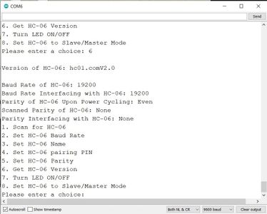

Step 13: Choice #6: Get HC-06 Version
Enter "6" then click the Send button will cause the Configurator to enter choice #6: Get HC-06 Version
Upon receiving this request, the Configurator will retrieve the version from the HC-06 module
Once completed, the Configurator would return to the main menu

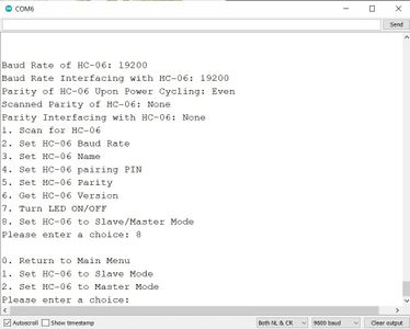

Step 15: Choice #8: Set HC-06 to Slave/Master Mode
Enter "8" then click the Send button will cause the Configurator to enter choice #8: Set HC-06 to Slave/Master Mode
Again, the Configurator will remain in this submenu until a choice "0" was received.
The official HC-06 will only run under the Slave mode. Some unofficial HC-06 modules do claim to cover both Slave and Master modes. During the testing, It did not have any effect on the HC-06 modules on hand. A decision was made to have this command implemented as it was part of the official manual.
