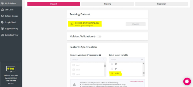

Step 7: Importing the Dataset and Choosing the Target Variable

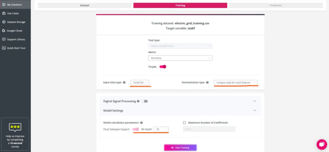

On the Neuton platform, we will upload the dataset for our use case and select 'stabf' as the target variable.
In the training parameters, set the Input data type FLOAT32 and Normalization type “Unique scale for each feature”. Then proceed to model training.

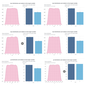

Step 8: Training and Exploratory Data Analysis
Once the training has started, we see the model data analysis which helps us to understand the close relationship between the original dependent and independent variables.

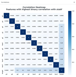

Step 9: Correlation
It is important to verify the correlation between each numerical feature and the dependent variable, as well as the correlation among numerical features leading to potential undesired collinearity. The heatmap below provides an overview of the correlation between the dependent variable (‘stabf’ or ‘target’) and the top 10 numerical features with the highest binary correlation to the target.

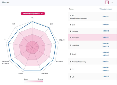

Step 10: Model Accuracy
After the training is over, we can see the model metrics: the model accuracy is 0.921435!

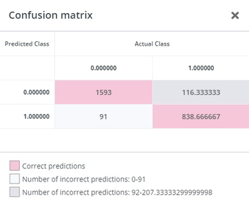

Step 11: Classification Performance
We can also see the classification performance using the generated confusion matrix.

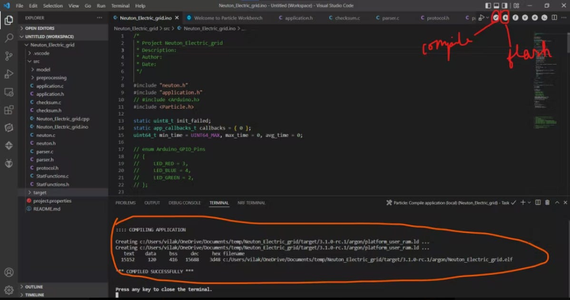

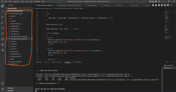

Step 14: Setting Up Particle IDE and Workbench
Add your downloaded Neuton model inside the Particle Workbench project folder. Your folder structure will look like this (checksum, parser, protocol, application and StatFunctions) These files are required to make predictions on data received over serial communication using the CSV uploader tool.
Here is the most important function:
static float* on_dataset_sample(float* inputs)
 if (neuton_model_set_inputs(inputs) == 0)
 uint16_t index;
 float* outputs;
 uint64_t start = micros();
 if (neuton_model_run_inference(&index, &outputs) == 0)
 uint64_t stop = micros();
 uint64_t inference_time = stop - start;
 if (inference_time > max_time)
        max_time = inference_time;
 if (inference_time < min_time)
        min_time = inference_time;
 static uint64_t nInferences = 0;
 if (nInferences++ == 0)
        avg_time = inference_time;
else
        avg_time = (avg_time * nInferences + inference_time) / (nInferences + 1);
      RGB.control(true);
      RGB.color(255, 255, 255);   // white
 switch (index)
 case 0:
        Particle.publish("Prediction: Stable Grid", String(index));
        RGB.color(0, 255, 0);
 break;
 case 1:
        Particle.publish("Prediction: Unstable Grid", String(index));
        RGB.color(255, 0, 0);
 break;
 default:
 break;
 return outputs;
 return NULL;
Compile the application in the cloud or locally. Once compiled, you are ready to flash it to your device. Make sure you have selected the correct Particle OS for your device.

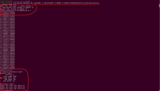

Step 15: CSV Data Upload Utility
We are going to test our predictions by sending the test data features from our test dataset CSV file over a USB serial port.
  • Install dependencies,
# For Ubuntu
$ sudo apt install libuv1-dev gengetopt
# For macOS
$ brew install libuv gengetopt
  • Clone this repo,
$ git clone https://github.com/Neuton-tinyML/dataset-uploader.git
$ cd dataset-uploader
  • Run “make” to build the binaries,
$ make
Once it’s done, you can send the CSV file over USB.
$./uploader -s /dev/ttyACM0 -b 230400 -d /home/vil/Desktop/electric_grid_test.csv

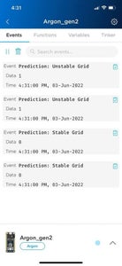

Step 16: Prediction
The prediction is printed on the Particle IoT cloud.
