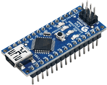

1.Arduino Nano or

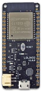

2.ESP32 WEMOS lolin

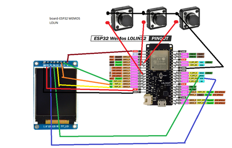

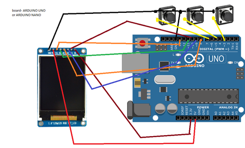

Step 1: Schematic Diagram
Make the connections of the components according to the diagram below.Attention:a schematic is with Arduino, and the other for ESP32 depending on which option you choose.
Step 2: Construction
In this stage of the project, we connect the components strictly following the electrical diagram. The construction is particularly easy, it does not require more than 10 minutes.
