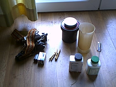

Step 1: Things You'l Be Needing
Here's a list of things you'll want to have to hand:
Developing tank
Measuring Jug
Thermometer
Developing solution
Fixing Solution (Fixer)
Clothes Pegs/Film Clips
A film to develop
Film extractor (possibly optional)
A pair of scissors
A clock

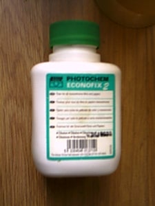

I got my developing tank, measuring jug, fixing solution, thermometer, "film clips" and film extractor for 25 pounds (the film extractor being the most expensive of the lot at 10 pounds, apparently they are "as rare as hens teeth" according to the nice man in the shop.)
All the chemicals (Fixer and developer) can be bought from jessops (in the UK), just make sure you get ones for black and white film, and quite alot of camera shope will sell black and white film.

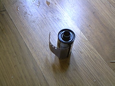

With a bit of foresight this step can be made alot simpler, it can be a total pain in the arse. When you wind the film back in your camera make sure the film doesn't retract full into the canister and a little bit is left poking out, when the film detaches from the right hands spool in the camera it can usually be felt, you want to stop at this point so it doesn't full wind back into the canister (see photo for about how much you'll be wanting to leave sticking out).

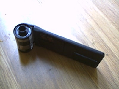

If the film does end up full back inside the canister there are two options:
1.) Use a film extractor- These are really fiddly, but once you get the hang of it they are fairly simple, instructions on how to use are usually printed on them. (This is what i usually end up doing)
2.)Use a special film cannister opener- these are like bottle openers and you use them to pop off one end of the film cannister- THIS MUST BE DONE IN TOTAL DARKNESS otherwise the film will get exposed and be ruined. (Never tried using one of these before, but they are fairly straight forward by the looks of it)

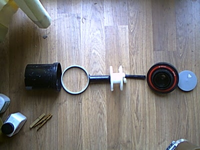

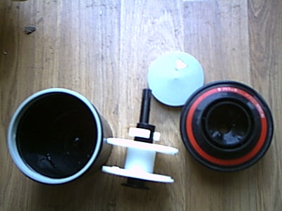

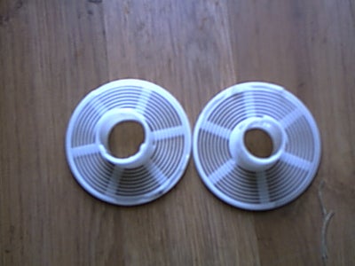

Step 4: The Developing Tank

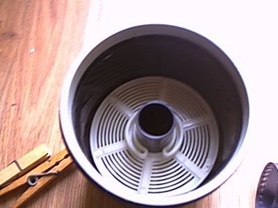

The developing tank is where the magic will happen.
The tank is what the film is put into when your are developing the photo's, it has a light proof pouring spout at the top where you can put the developing chemicals in without letting any light get onto the film and ruining it.
The tank consists of a number of parts (from left to right in the photo):
The Tanky Part- this is where all the chemicals are contained and stopped from flooding all over your floor
Light proof seal - This fits in a recesses in the top of the the tank and helps stop light getting in and chemicals coming out.
Central Spool - this is what the film spool and retaining clip slide onto, it sits in the centre of of the tank.
Film Spool - The film is wound out of the film canister and around this spool, it has ridges in the two end pieces so each wind of the film is kept separated and chemicals can get to the film, it can also be split apart in the centre for easy extraction of the film once it is developed.
Retaining Clip- This is a small plastic C shaped clip (can be seen resting on the edge of the film spool), once the film spool is slid onto the central spool it slides on after and holds the film spool in place making sure the film sits at the bottom of the tank amongst the chemicals.
Misc. Twisting Thingy - this is the small black plastic tube sitting between the film spool and top cap, not all developing tanks have these, it slide down the centre of the top cap and fits into some notches in the centre of the central spool, it allows you to rotate the central spool and film spool while the film is developing to help agitate the chemicals, although shaking the tank works just as well.
Top Cap- This screws onto the top of the developing tank and has a hole in the top that allows chemicals to be poured into the tank without letting any light in.
Top-Top Cap - This is the grey plastic cap that fits on top of the top cap and stops any chemicals from coming out if you shake or drop the tank while it is developing.

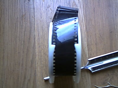

Step 5: Loading the Film Spool
THIS STEP MUST BE DONE IN TOTAL DARKNESS!
The film you will be taking out of the cannister is still reactive to light, any light you let onto the film until it is fully developed will expose the film and all your pretty pictures will turn out white.
I do this step under my covers in my room with all the lights off and the windows closed and at night, if anybody comes into your room/threatens to turn the lights on just scream "I'm having some happy alone time!!" at them, and upon seeing you furiously scrabbling under your bed sheets will generally make a swift exit.

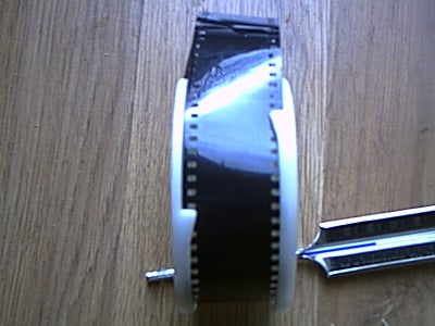

The film spool has a clever little mechanism involving small ball bearings so that when you twist it one way then twist it back the film will advance onto the spool and be pulled out the canister. You may have to manually pull a length of film from the cannister to get it started, but once its got going things generally get easier. Once all the film is loaded onto the spool and out the cannister take a pair of scissors and snip the cannister off the end of the film.
This takes some getting used to, especially because you will have to do it in darkness, I recommend sacrificing a film to practice with in the light first, then try with you eyes closed, then give it ago in total darkness.
Also make sure you only touch the film by the edges when you are doing this otherwise you can scratch your negatives.(the third picture is an example of how nasty this can look)

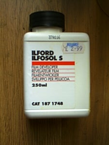

Step 7: The Chemicals
Getting the chemicals may be slightly tricky depending on where you live, ask around some local camera shop and they should be able to point you in the right direction. I got mine from Jessops (in the UK) they've got a website where you can order from.
The two chemicals you'll be using are:
The developer - I'm not sure of the chemistry behind developing films but from what I've heard on the grape vine the developer deposits silver crystals on the film on the area that has been exposed by light causing them to go dark (hence images turn out negative).
The fixer - The fixer fixes the deposited silver crystals in place and stops the film from being light sensitive.
These chemicals usually have to be diluted before you use them, the dilution rates will depend entirely on the brand you have purchased, for me the developer was diluted 1:14 and the fixer was diluted at 1:4
Also depending on the brand you may be able to reuse the chemicals, my developer is single use but my fixer can be used about 4 times.

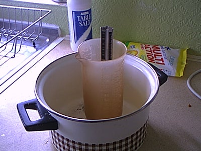

Step 8: Getting the Temperatures Correct
The developer is extremely temperature sensitive (the fixer slightly less so), for most brands the optimum temperature is 20 degrees C (or 68 degrees Fahrenheit). It's very important to get the temperatures right so a decent thermometer is required.
The way i get my temperatures right is to use hot and cold water to dilute the fixer and developer until they are at roughly the correct temperature and then sit them in a pair of measuring jugs in a pan filled with either hot or cold water until they are at the correct temperature.

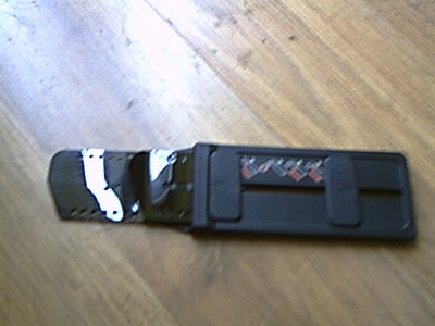

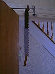

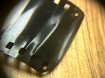

Step 10: Removing the Negatives

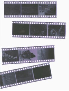

This is by far the most exciting step, it's quite incredible to see pictures you've developed yourself.

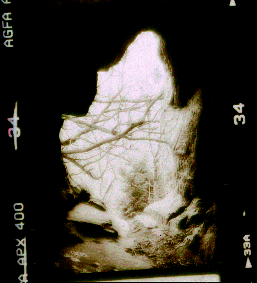

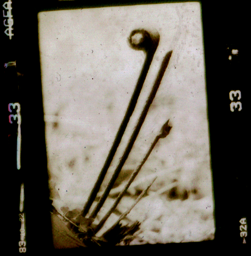

Take the film spool out of the developing tank and remove the film (this can be done by twisting the film spool until it clicks and the two halves should separate.) Be careful to hold the film only by the edges and find a dust free area of your house/room/blimp and using some clothes pegs, peg up the film to dry, also put a peg on the bottom of the film, this should help to keep it straight and stop it curling up.
(note: your film will be longer than the one in the picture, this is a scrap i found for demonstrative purposes.)
