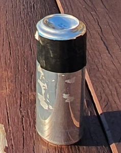

Having made a pinhole camera from a beer can (Beer Can Pinhole camera), the idea of developing the image in the same beer from the can appealed to me.

I tried a beer and didn't like it so poured it into a bottle and made the can into a pinhole camera. The beer was later used to develop the image.

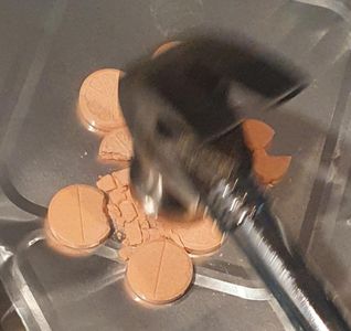

The beer was warmed by putting the bottle containing it into a sink of hot water. It was then poured into a container and experimented by using: 50 grams of washing soda with 7 crushed vitamin C tablets stirred in.

The covering of the pinhole was removed for 1 minute to take the photo. A darkroom was created in my bathroom as it has no windows in it. The red light of my camping head torch allowed me to see. The image was developed in the beer developing mixture for 2 seconds, it went dark almost instantly. While the result wasn't great, an image was made out and this was encouraging.

Step 8: Adding Crushed Vitumn C Tablets
3 tablets of crushed vitumn C tablets along with 50 grams were added to the mint solution.

I also spray painted the inside of the pinhole camera cans with black matt paint.
