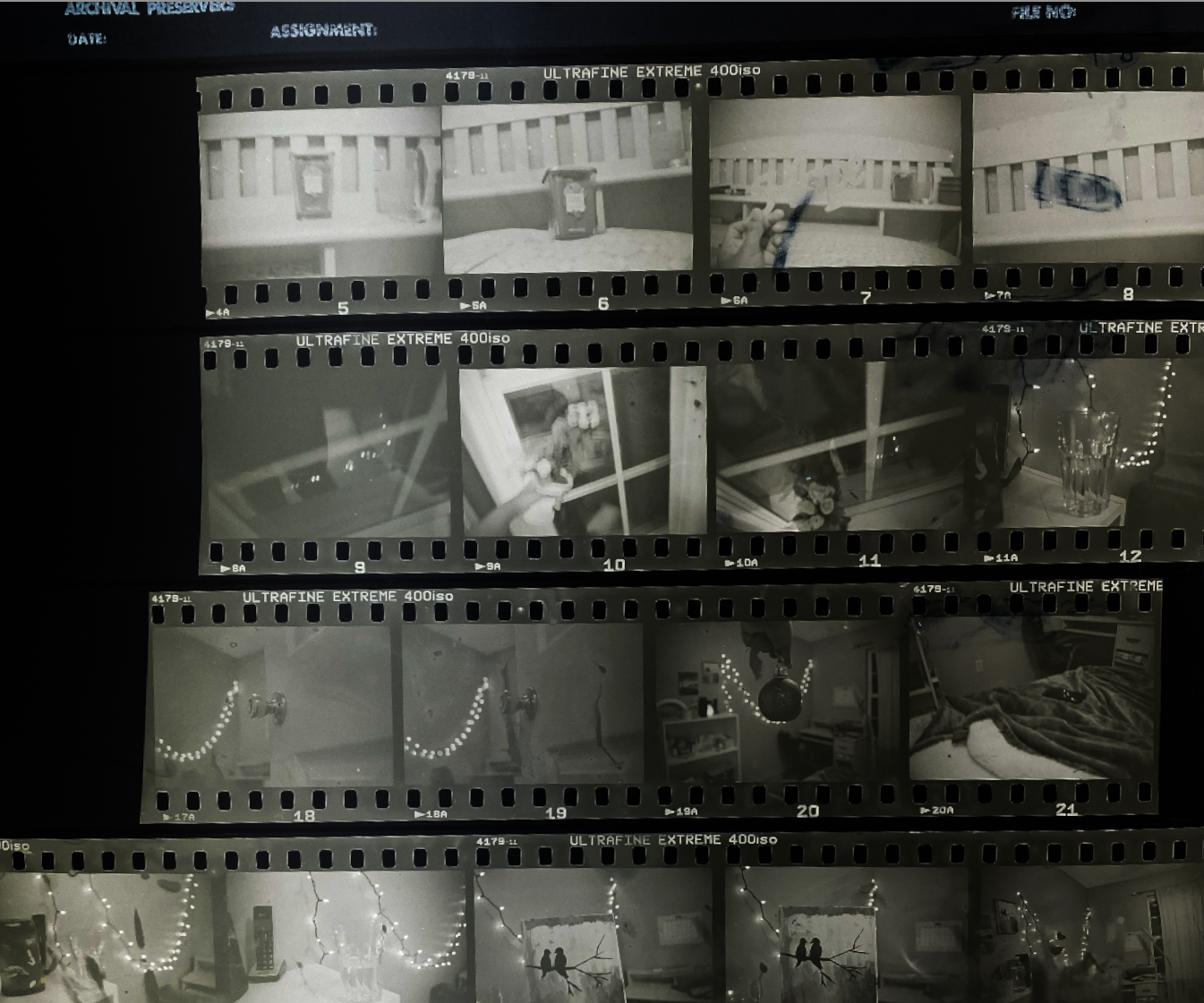

Step 8: Finishing the Film
- Return the hanging clips to the tray on the sink.
- Take your film to the light boxes holding it by the edges as to not get fingerprints on the film
- Carefully cut the film apart in rows containing 5 frames each and discard any blank or black areas of the film
- Slide film into a negative sleeve with the shiny side up and the numbers across the bottom
- Now you can view your negatives safely without scratching them with the loupe and they are ready to be made into a contact sheet!
(See THIS VIDEO on finishing the film)
