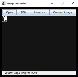

Step 8: Adding a Sacrificial Pixel (line) at the Bottom of Each Bitmap
Apparently, that’s the extra work. The reason why I did it, is that I decided to use the image converter I wrote earlier to convert the bitmaps to the arrays. And that program spoils the pixel (the line to be exact) on the bottom of the bitmap
The picture in this step contains the “Alef” letter with the sacrificial pixel (line) at the bottom.

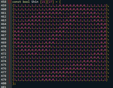

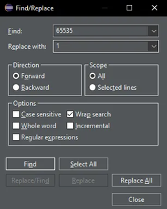

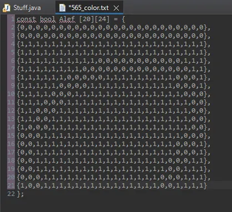

Step 9: Converting Each Character Into an Array
Finally, it’s time to convert each character into a format that can be “understood” by the embedded system.
At first, I converted the character to the array using the image converter, then I opened the resulting array, replaced the sequence “65535” with “1,” removed the column representing the spoiled pixel, and renamed the array while also changing its type to “bool.”
Step 10: Adding the Missing Letter
While converting the characters, I noticed that the letter “Shin” was missing. So, I took a photo of the sheet that contained the missing letter, resized it, redrew the letter, saved it into a separate bitmap, and finally converted it to the bool array.

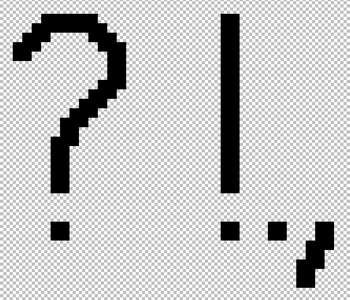

Step 11: Adding the Comma, Dot, Exclamation Mark, and Question Mark
I just figured that the font is missing the following characters. Without further ado, I added them.

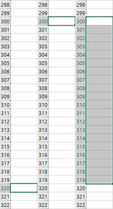

The first picture in this step contains the part of a function responsible for drawing the string using the custom font.
The second picture in this step contains the value of the pointer (first two columns); 20 pixels taken by the “Alef” letter (third column). Note that this picture depicts the horizontal pixels.

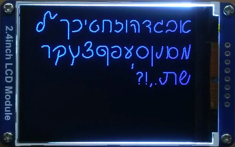

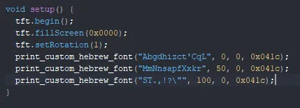

Step 14: Displaying All Characters
I called the function three times and provided it with all the characters associated with the font’s characters. While using Latin letters to represent the Hebrew ones might be a bit inconvenient, it’s the best solution that I found (for now).

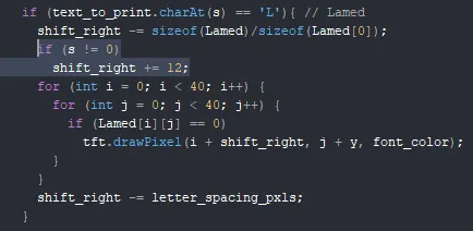

Step 15: Fixing the Improper Spacing for the “Lamed” Letter
If the “Lamed” letter isn’t the first in the line, the gap between it and the letter before it is too big. To fix this problem, I wrote two lines of code that shift the “Lamed” letter twelve pixels to the right if it’s not the first one in the line.

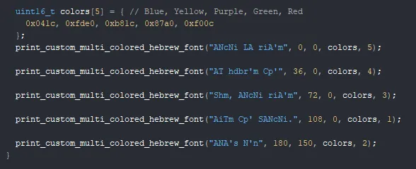

Step 16: Writing a Function to Display Multi-colored Text
Aside from writing the function that displays the string using the custom font, I decided to write the function that also displays a multi-colored string using that font.
To do so, I modified the original function adding two arguments to it;
uint16_t font_colors[] — Array with colors;
int how_many_colors — Number of colors to take from that array.

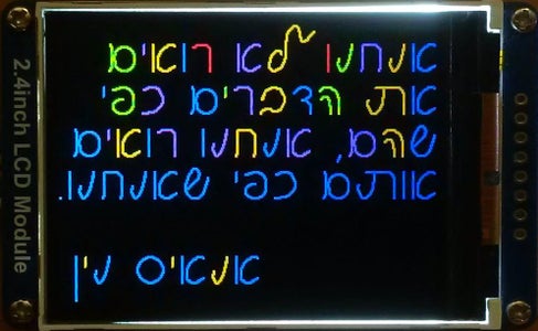

Step 17: Testing the End Result
Well, I believe that the best way to demonstrate the result of this work to you is to show you a photo of the display showing the quote that I took from one of the episodes of the “Losing Alice” TV show.
By the way, I made this font a work of the public domain and uploaded it to GitHub. So, if you want to use this font, don’t hesitate to do it.
