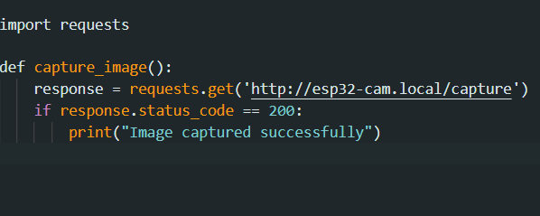

Step 3: Configuring the Raspberry Pi for Computing and Firebase
Set up the Raspberry Pi with Raspberry Pi OS, connect it to your network, and install necessary Python libraries (firebase_admin, RPi.GPIO, etc.). The Pi will handle logic processing, trigger the ESP32-CAM, and upload images to Firebase.

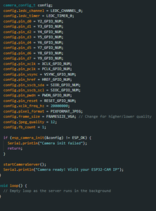

Step 4: Setting Up and Programming the ESP32-CAM
The ESP32-CAM will take pictures when prompted by the Raspberry Pi. Connect the ESP32-CAM to power and flash it with a sketch that allows remote image capture via an HTTP request.

  2. The Raspberry Pi triggers the ESP32-CAM using a request and uploads captured images to Firebase.
  3. Use Python scripts on the Raspberry Pi for handling logic, image requests, and data uploads.
