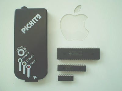

You'll need a programmer — for those who are new to this, a programmer is a little device that plugs into your computer and your circuit, and transfers your compiled program onto the PIC/AVR. There are plenty of 'official' and unofficial programmers — I'm using a PICKIT 2 clone by Sure Electronics (They're an amusing Chinese company who print "Have fun with us" on their product boxes"), but you can use almost any programmer. The important thing is that it has a terminal interface, i.e. you can control it via the terminal. Examples of this include usbpicprog, which looks like a great little low cost PIC ICSP programmer.

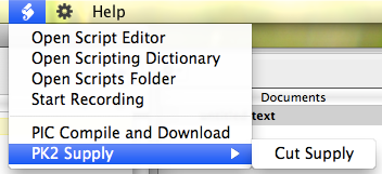

What you need to do now is add AppleScripts to TextWrangler that automatically detect the model of PIC, compile your code and burn it to the PIC. If you're using TextWrangler, gputils and pk2cmd, you're in luck, because I've already written them for you! Download the attached files "01)PK2 Compile and Download" and "02)Cut Supply".

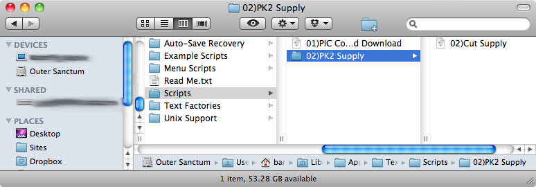

TextWrangler allows you to add your own AppleScripts to the scripts menu (Little Scroll Icon). To do this, you need to move the AppleScripts you've downloaded into the folder ~/Library/Application Support/TextWrangler/Scripts/. Put The Compile+Download script straight in, and put the Cut Supply script in a new folder called "02)PK2 Supply".
The numbering system forces the scripts to appear in a particular order. Scripts in folders appear in a sub-menu.
You might want to move any example scripts away from the Scripts folder. I moved them into ../Example Scripts for future reference.
Open up TextWrangler. Your Scripts Menu should look like the second screen shot.

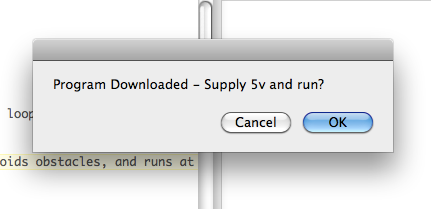

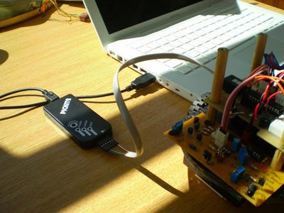

Now you have a bare-bones system set up, give it a go. Plug in your MCU board, or ICSP header to a breadboarded PIC circuit, load up a simple program (LED Flash, motors forward, that kind of thing), and try the PIC Compile and Download menu item. If all's well, it should ask you if you want to supply power to the circuit via PK2 (second screenshot) — up to you. If you do, use the PK2 Supply -> Cut Supply menu item to cut the supply.

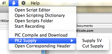

I have two more scripts that you might find useful… One which supplies 5v through the PK2 without having to compile, and another which tells textwrangler to open the PIC's include file (if you're using gputils installed to the default location) for reference. They are attached, just pop them in TextWrangler's Scripts folder as before.

Finally, the script displays dialog box asking if we want to run a command which sends 5v out of the PK2. This voltage can be changed if you have a preference for 3.3v circuits.
