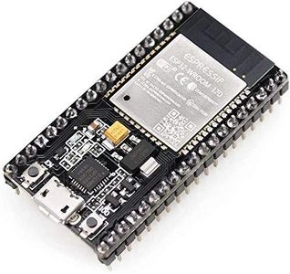

Step 1: The Core of the CanSat Is the ESP-WROOM-32
To carry out the primary mission during descent, the CanSat has to measure barometric air pressure and temperature. The relevant sensors must be connected to an ESP-32 board. The ESP-32 board processes the sensor signals. The data ESP-32 board produces is sent by radio signals to a ground station. ESP-32 boards are able to read inputs from a sensor and turn them into an output. You can instruct your board on what to do by sending a set of instructions to the microcontroller on the board. To get started with ESP-32, follow the next steps.
The ESP32 chip comes with 48 pins with multiple functions. Not all pins are exposed in all ESP32 development boards, and some pins cannot be used. The figure below illustrates the ESP-WROOM-32 pinout. You can use it as a reference if you’re using an ESP32 bare chip to build a custom board:
