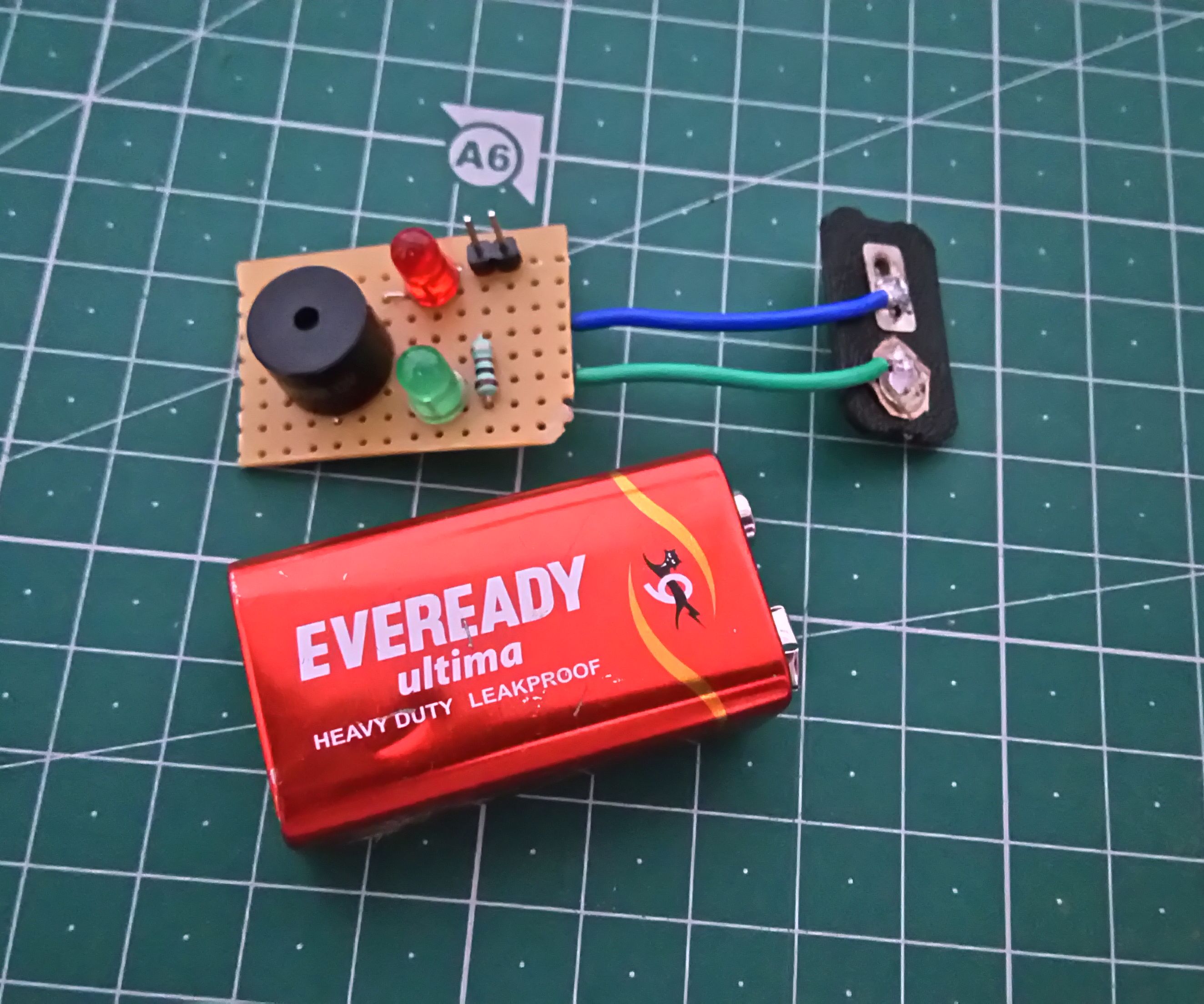

Step 4: The 5V Regulator
For this one, You'll need,
1) 5V LM7805 IC (Linear)
2) Heat sink and screws (optional)
3) 1uF and 0.1uF capacitors
4) 3mm GREEN LED and 100 ohm Resistor (optional)
Just solder them according to the above schematic and your done! And yeah, take necessary precautions.
Also, I added a switch between the battery and the 5V Regulator circuit as it would be handy if I were to shut it down. I got rid of the terminal blocks and directly soldered the connections as they were causing some loose connections and breakages in the circuit. Moving on "Step 5".
