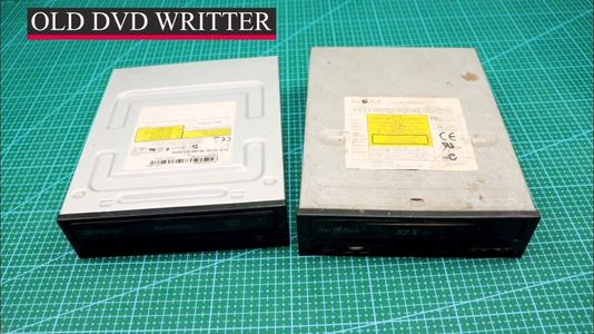

Step 1: DVD Drive Stepper Mechnaism
We need two DVD writers mechanism for this project. One for X-Axis and another one for Y-Axis. You can find this DVD writer from broken CPU or local hardware shop. I also got from the local hardware shop at very cheap prices. Now its time to disassemble the DVD writers.
  • Use Philips head screwdriver to remove all screw.
  • Unplugged all the connectors and cables from dvd drive
  • Open the disk holder and unscrew the sliding mechanis.
  • Detached the Sliding mechanism.
The stepper motors are 4-pin Bipolar Stepper Motor.

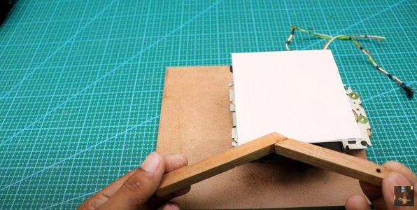

Step 4: X-axis and Y-axis Co-ordinates Movement.
I’ve attached the slider of X and Y-axis together in perpendicular to each other, using glue between them. And also attached a cut wood piece above it as a working bed.

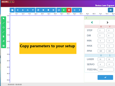

Step 11: Setup the Benbox Laser Engraver Parameters
The last step is to set up the parameters for the engraver.
1. Click on the blue menu icon at the top right-hand corner of the software.
2. Click on the right arrow underneath the menu icon to access the parameter list.
3. Enter the parameters’ values as depicted in the photo.

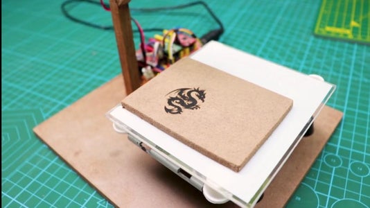

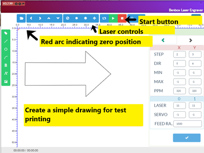

Step 12: Making Your First Engraving
This starting spot will correlate to the red arc at the (0,0) position (refer to image). Draw an simple image using the drawing tools on the left.Press the green start button to start the print. Click the circular laser button with adjust until the beam is sharp.
Step 13: Congratulation Successfully Making Your First Engraving Machine
