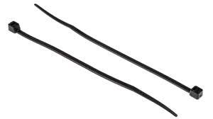

zip ties

When it is cut out, we untie one side of the struts with the string. we thread this string through the small holes in the triangle. the last hole is back through the strut and make a knot. we connect the rest of the triangle with zipties. we also connect the batten with zip ties at a 90° angle to the triangle.
