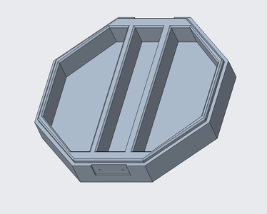

Carefully consider the questions you answered previously in your planning. In my example I went with a hexagonal box with 16mm depth to easily hold dice for dnd game.

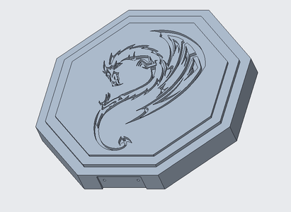

On the top, I stenciled a dragon design to easily print and allow clear indication that this box was for dnd games.
On the bottom, I allowed for separation barriers into three sections to hold dice and dnd figurines and keep things separate while storing or while a game in being played.
I have attached the STL files of the prints that I made here. Feel free to use mine as your base and customize it as you need!
