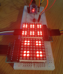

Welcome to this exciting Arduino project where we'll create an interactive electronic dice using an Nano V3 microcontroller, a pushbutton, and two LED matrix displays. When the button is pressed, the LED matrices will simulate rolling dice by displaying an animation and then show random dice faces. This project is a fun way to dive into programming microcontrollers and working with LED displays.
Step 1: Circuit Connection
Nano V3 -> LED Matrix
D12 -> Din
D11 -> CLK
D10 -> CS
5V -> VCC
GND -> GND
The Button is connected to D2 and GND and is pulled LOW when pushed.
The second LED Matrix is daisy-chained.
