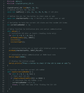

Step 2: Code Part 1
The provided Arduino code initializes an array `ledPins` containing pins connected to LEDs (pins 13 to 8) and sets pin 6 (`checkButtonPin`) as an input with a pull-up resistor. Upon setup, it configures these pins accordingly, initiates serial communication at 9600 baud, and prompts via the serial monitor to press `checkButtonPin` to determine the current LED number (1-6). The `readCurrentLedNumber()` function iterates through `ledPins`, identifying which LED is lit by checking each pin's state (`HIGH`), and updates `currentLedNumber` accordingly. When `checkButtonPin` is pressed, the function prints whether the detected LED number is even or odd, providing real-time feedback based on the LED's status and button press. This setup enables interactive monitoring of LED states and user engagement via the serial interface for immediate feedback on LED status and parity. I also declared the I2C lcd screen to use to print later on

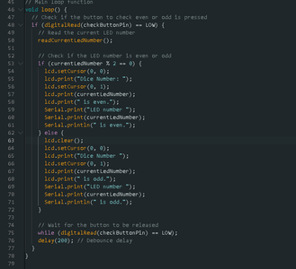

Step 3: Code Part 2
In the `loop()` function, the code continuously monitors whether the button connected to `checkButtonPin` is pressed (`LOW` state). When the button is detected as pressed, it calls `readCurrentLedNumber()` to determine which LED is currently lit based on the pins defined in `ledPins`. It then evaluates whether the detected LED number (`currentLedNumber`) is even or odd using the modulo operator (`%`). If the LED number is even, it outputs a message to the lcd and serial monitor stating that the LED number followed by "is even." If the LED number is odd, it prints that the LED number followed by "is odd." After printing the result, the code waits for the button to be released using a `while` loop that checks if `checkButtonPin` is still `LOW`, ensuring debounce and preventing multiple detections from a single button press. Finally, a small delay of 200 milliseconds (`delay(200)`) further debounces the input, ensuring accurate button press detection and preventing rapid iterations through the loop due to physical button bounce. This structure allows for real-time feedback on the parity (even or odd) of the currently lit LED whenever the button is pressed, facilitating interactive monitoring and user interaction via the serial interface.
