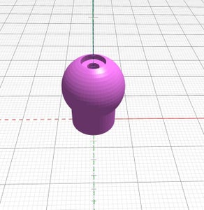

1: Pommel (holds the Castellation top in place) - 16 x 16 x 19.4 mm

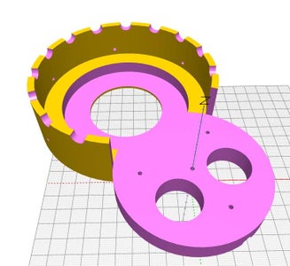

2: Castellated top (holds the clear cylinder in place and provides access to the staircase) - 103.3 x 103.3 x 15 mm

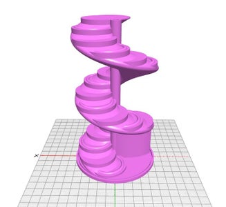

3: Spiral staircase - 102.3 x 102.3 x 174.5 mm
4: Arena (bounded area into which the dice comes to rest) - 169 x 193 x 42 mm
5: Guide (ensures the wireless die comes to rest in the centre of the wireless charging pad) - 130 x 129.6 x 17.3 mm

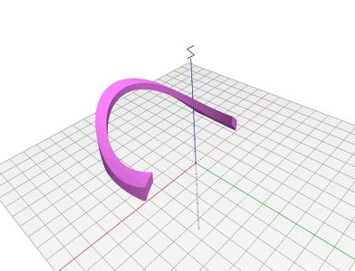

Step 5: Exit Arch
Using the cylinder created from the bottle an exit arch is required to allow the dice to exit the spiral staircase.
Take the arch previously printed and using it as a template position it to the outside of the cylinder at the end which will sit at the base of the spiral staircase. Ensure the base of the arch is level with the base and rim of the cylinder by sitting the cylinder on its rim, tape the arch to the bottle by its front without the tape extending into the inner perimeter.
Mark the inner perimeter of the arch, remove the template and cut out along the line with scissors.
Apply a suitable adhesive and position the 3D printed arch around the opening and press in place, if necessary hold in place with tape until the adhesive cures.

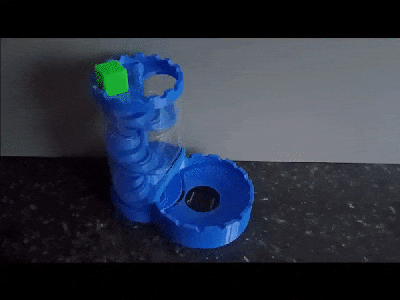

Drop the dice through the hole in the castellated top and watch it cascade down the tower to land on the pad and illuminate the pips of the appropriate number on the uppermost side of the dice.
