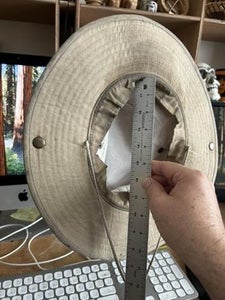

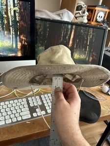

Step 2: Hat Size
The first step in designing the hat is to determine your hat size or more accurately the size of an oval that will fit on your head. Traditional hat sizes come from the measurement of the circumference of your head. This is good to know, but the basic shape of the hat is an oval that matches the length and width of you head.
An easy way to do this is to get a hat you currently own and measure it with a ruler. Measure the length (front to back) and width (side to side). These are the dimensions of the oval that will form the inside base/opening of the hat. Other options are placing a ruler on top of your head to measure length and width or if you have them, using a pair of calipers to measure your head. Make sure to get the widest parts of your head.
I recommend doing a test fit by drawing an oval on some cardboard and cutting it out and them making sure it fits over your head. You can make adjustments till you find the size that fits best.
Remember, that is the inside dimension. When you design the foam parts, make sure the thickness of the foam goes outwards not inwards. For example the inside width of my hat is 6.63" and then I add 2 times the thickness of the foam (0.16" or 4 mm), to get an outside width of 6.95" (6.63 + (2 x .16)).
In addition, make sure to figure out the depth of the hat. This is how much of the internal volume your head takes up or from the top of the hat, or your head, to the bottom of the hat's brim. If your measuring an existing hat, stick the ruler inside with the end at the top of the hat and measure where the ruler comes out at the bottom.
This is important because the top hat is taller then you need for your head, but you still need to know how much of the internal volume your head will take up. This hat has an internal lid or cap, inside that will rest on top of your head. The internal cap is also the floor the dice tower sits on.
