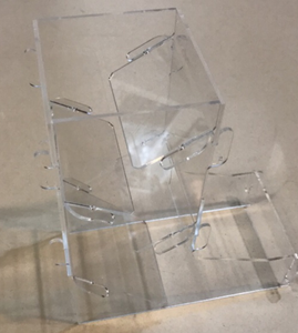

Step 5: 組裝 Assemble
開始組裝。
請將切下來的板子組裝成圖片上的樣子即可,因過程簡單而省略。
請注意,總共有7個零件
2個側面的L型板子
4個小板子
1個中板子
如果組裝過程發生無法卡入的狀況,請不要硬裝,請用尺確認板材厚度與凹槽的寬度,並重新調整檔案組裝部分的尺寸後重新切割和組裝。
Start assembly.
Please assemble the cut board as shown in the picture, and it is omitted because the process is simple. Please note that there are 7 parts in total 2 side L-shaped boards 4 small boards 1 medium board If there is a situation that cannot be snapped in during the assembly process, please do not install it hard. Please use a ruler to confirm the thickness of the plate and the width of the groove, and re-adjust the size of the assembly part of the file and then cut and assemble again.
