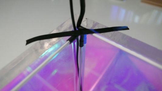

With your acrylic cube upside down so its open bottom faces up, begin by placing the first CCFL section. Again the black lead should be placed on the top surface of the cube (now the bottom in this orientation) with the red lead at the bottom (near the open end).
Place your next CCFL section so that its middle tube is in the corner of the previous section's black wire. Ideally, the middle tube will cover the black wire, allowing the wire to run up behind it in the corner.
Place your next CCFL section, agin with its middle tube in the corner of the previous section's black wire. And again for the final section.
If you find that the CCFL sections are not fitting in the width of the box, you may need to carefully re-bend the joints so that a the length of the tubes is shortened.
The CCFL's will be tight in the box, this is what keeps them all positioned. They should be positioned in a way where one section stands behind the next, each neighboring section pinching the previous one into its corner.
When all the sections are placed in their appropriate corners use strips of electrical tape to tape over the corners. This tape will keep the sections tucked into their corners. Next take the bottom section of the cube and carefully feed the wires through the holes in the appropriate corners. Pull the wires through until the bottom panel fits flush agains the cube.
