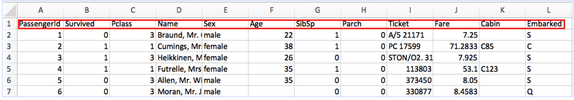

This dataset is a csv (Comma-separated values) file, which can be opened either using Excel or a simple text editor.
The features are in columns, and some of them are very interesting:
  • Survived : you already know. It's binary, 1 or 0.
  • Sex: male or female. An important feature: you have already heard the phrase "Women and children first"
  • Fare: the price of the ticket... If a passenger paid a higher price, he was treated better by the crew.
  • Pclass: passenger class. There were 3 classes, distributed in the boat as shown below.
  • Age.
The other features (such as the passenger's name, her ticket number, etc) are less important, and I made a lighter version of the dataset which is available below, keeping only 4 features. It will be used by the algorithm.

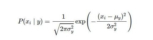

In another solution, the naive Bayes method makes a new assumption: the values associated with each class are distributed according to a normal (or Gaussian) distribution. We then need to calculate the mean and standard deviation for this feature, and apply the Gauss formula:
Here xi is the feature and y is the class.
This is what is actually implemented in the code. If any feature is not found in the dataset, then the means and variances of features and classes are calculated and the likelyhood of this particular feature is estimated using a Gaussian distribution.
