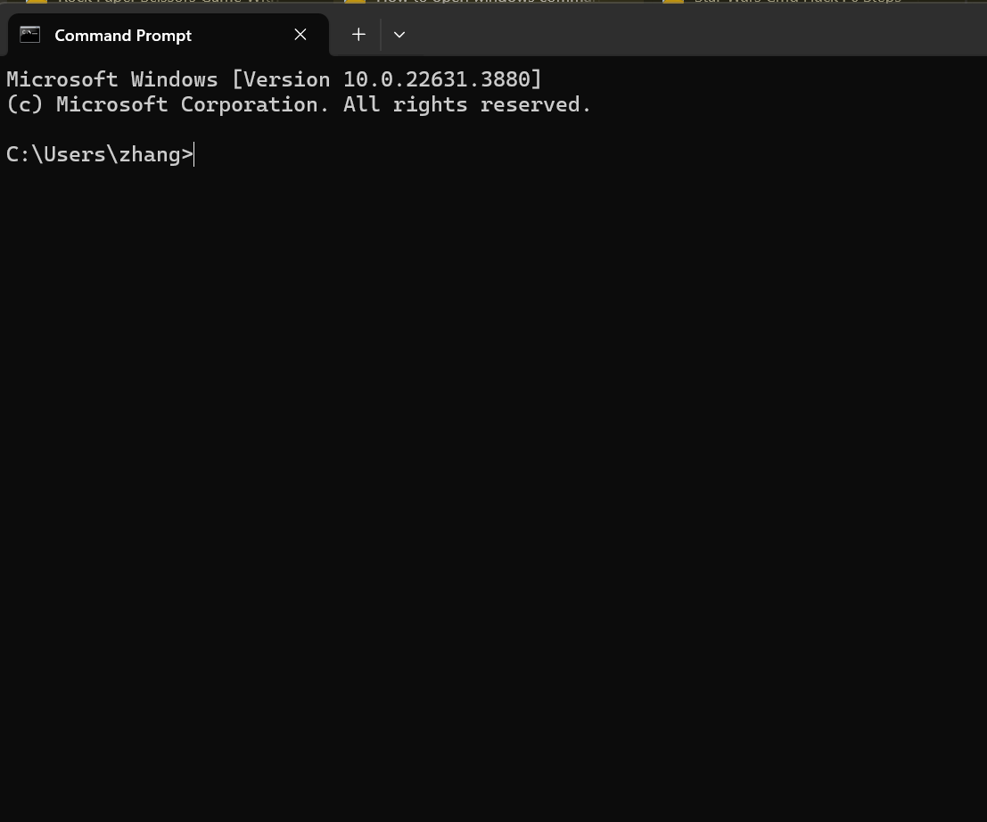

Open the cmd and type in:
fecho /?
This will give you the info on how to use it. For example:
fecho "Hello, World!" Yellow
returns this:
This should work also in Batch scripts but if it doesn't use this instead:
call fecho *parameters*
