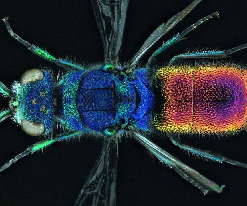

The second solution, decidedly more ambitious and performing, is self-contained (no other illuminator is needed) and is based exclusively on indirect/diffused light.
The main novelty, if compared to the simpler version, is that this illuminator can be put above the subject almost like a hat, and provides at the same time indirect illumination from the sides and from above, thus minimizing shadows and avoiding reflections.
A continuous dimmable LED strip, 1 meter long, is positioned to form a double loop, the inner ring with the LED's pointing outside, and the outer ring with the LED's pointing inside: both the rings illuminate from the two sides a white cardboard cylinder.
In other words, no LED is directly pointed at the subject. Everything is contained in the bottom of a plastic vase holder, with the "ceiling" coated by reflective adhesive paper.
In the ceiling, a central hole is made for the camera lens to peek in.
This illuminator is to be positioned like an hat over the subject, that obviously must be small enough to be entirely framed through the top hole.
The pictures show how the connector for the power supply and the dimmer is positoned externally.
With this set of illuminators I obtained the photo attached here as Figure 8 - please check also these six pictures of insects in diffused light, quite acceptable in terms of diffused illumination and reflections control.
