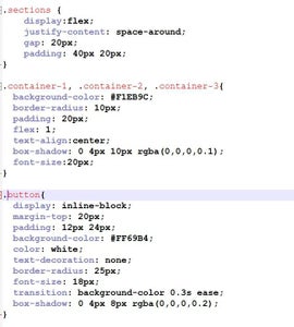

3>Adding containers and buttons: For this part, we add a section tag within which exist div tags for each container and button. All the containers have the same CSS code, so you can rename the classes to have the same name. Check the 6th image for the HTML code and the 7th image for the CSS code, and the output is shown in the 8th image. You can add additional CSS code when the cursor is placed on the button. (That is the color changes or the button gets highlighted.)

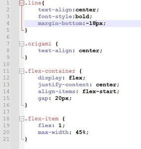

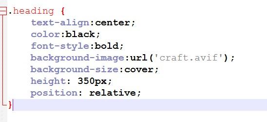

After the header and footer, it's time for the heading and content. For the heading, I created a section and used CSS to align it to the center and for bold text. You can use the <b> tag instead in HTML code for bold text. I have margin-bottom:-18px; to decrease the distance between the heading and the content after. And instead of background color, you can add an image.
For the content, I wanted it aligned to the center, but two videos to be aligned side-by-side. Side-by-side feature is the result of display: flex; but since this causes all the content under the class, including the text, to be aligned side-by-side, I used a div tag to group two videos and another div tag within for each video. (If the inner div tag is excluded, then the text will also be aligned side-by-side.) Now, simply adding display: flex; to the outer div tag is sufficient.

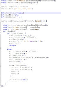

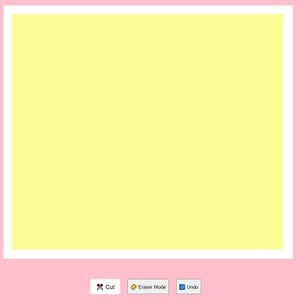

First, I began with the stencil maker game. I first wrote the instructions for it using the HTML code shown in the first picture and the CSS code shown in the 2nd picture. The output is shown in the 3rd picture. Again, instead of the background color, you can add an image. Now, it's time to add the canvas and paper on which we can create the stencil. We do this using JavaScript. Refer to this link for learning JavaScript: https://www.w3schools.com/js/default.asp (JS HTML DOM section). For JavaScript, we link the file at the end of the BODY (after the footer code) and not in the HEAD. We add it using this code: <script src="script.js"></script> where script.js is the JavaScript file name. For the canvas and paper:

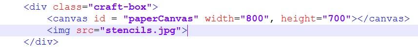

HTML~
<div class="craft-box">
<canvas id = "paperCanvas" width="800", height="700"></canvas>
</div>

The Canvas ID is used in the JS file. The width and height within the div class are just for the canvas. The canvas's width and height are added in the CSS file as well. We need both the HTML and CSS attributes. Before we add buttons to edit the paper, we should add JS code that adjusts the size and position of the paper. The code is in the 5th picture.
In the ctx.fillRect(23, 24, 750, 650); 23, 24 are the x and y positions and 750, 650 are the width and height. You can change them up based on how you would like the canvas and paper to be. The list of drawlines will come in handy when we introduce cuts and want to add the undo button, as the drawn lines are stored. The 6th image shows that when we click on the paper, a dot is visible, and when we click again on any other point on the paper, a line is formed. The 3rd click again produces the dot, so we can draw a different line at a different start point.

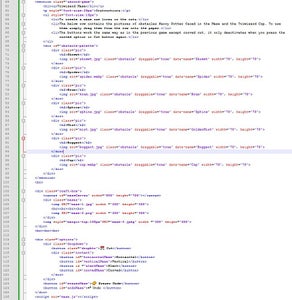

Now we need to add buttons in HTML so that when we click them, the cut, erase or undo modes are activated. For that, we add the code shown in the 7th image in the HTML file, the code shown in the 8th image in the CSS file and the output is shown in the 9th image. The background color and box shadow can differ. Now it's time to add the code in the JS file for all the buttons.
Check the file uploaded for the full code. Starting with the cut button, we will begin with the horizontal cut. Under the event listener click, we add a condition for horizontal mode, and within that, we have if (!startpoint), so that if we haven't clicked yet, it defines the start point. On the second click, it goes to the else condition and performs the cut. We also have a redraw function so that after every cut, any lines drawn or other cuts will be visible. The document. get...code block is to be added for every button we have in HTML. Vertical and Slant cuts are done in the same way. Curved cut is different because the shape varies from the line. We have to trace cursor movements, store them and then cut them. So, for that, we create new listeners called mouseup, mousemove, mousedown and a function that traces the cursor path. Under mousedown, we add an event listener (mousemove, tracecurve). Under mouseup, we push the traced path to the curved path list. The difference between curved cut and others is that for other cuts, we click on the button, click on the paper for the start point and then click on the end point to perform the cut. For a curved cut, after clicking the button, we must drag the cursor and the cut is made. If we click on the canvas, the curved cut mode is deactivated.

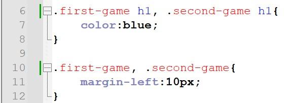

Now the canvas is all done for the game! Additionally, I placed some stencil pictures so that users can get inspiration from them. Check the 10th and 11th pictures for the HTML and CSS code, and the 12th picture for the final output. Remember to download the image to the same folder as the other HTML, CSS and JS files are in!

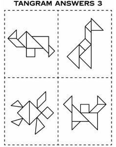

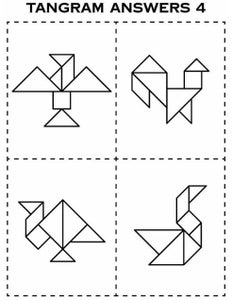

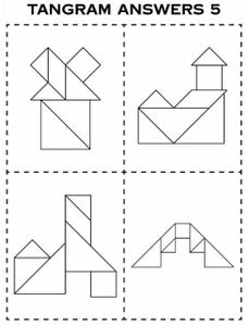

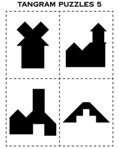

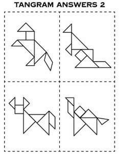

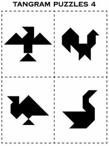

The HTML code is also the same, except that the pictures and instructions differ. I also added the answers to the Tangram Puzzles below the Canvas; the HTML code for that is in the last part of the first image. The CSS code:
.ans{
display: flex;
gap:20px;
margin-left:10px;
