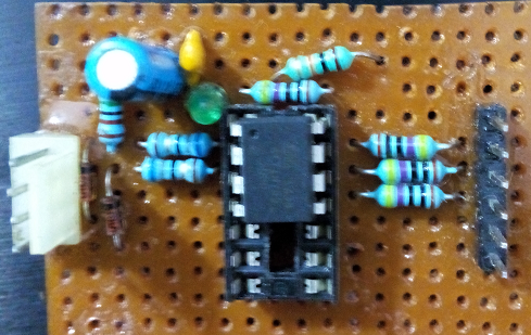

Step 1: Prerequisite
AVRISP MKII In-System Programmer
ATTINY85 Microcontroller
2 x 3.6V zener diode
2 x 68 ohm resistor
1 x 1.5K resistor
USB cable (get from broken mouse or keyboard)
Some wires

Step 4: Digispark Schematic
I provide two schematics, first one is the official schematic for Digispark, the other one is for testing purposes which the 5v is get from USB port and hence it is lesser components and much more simple.

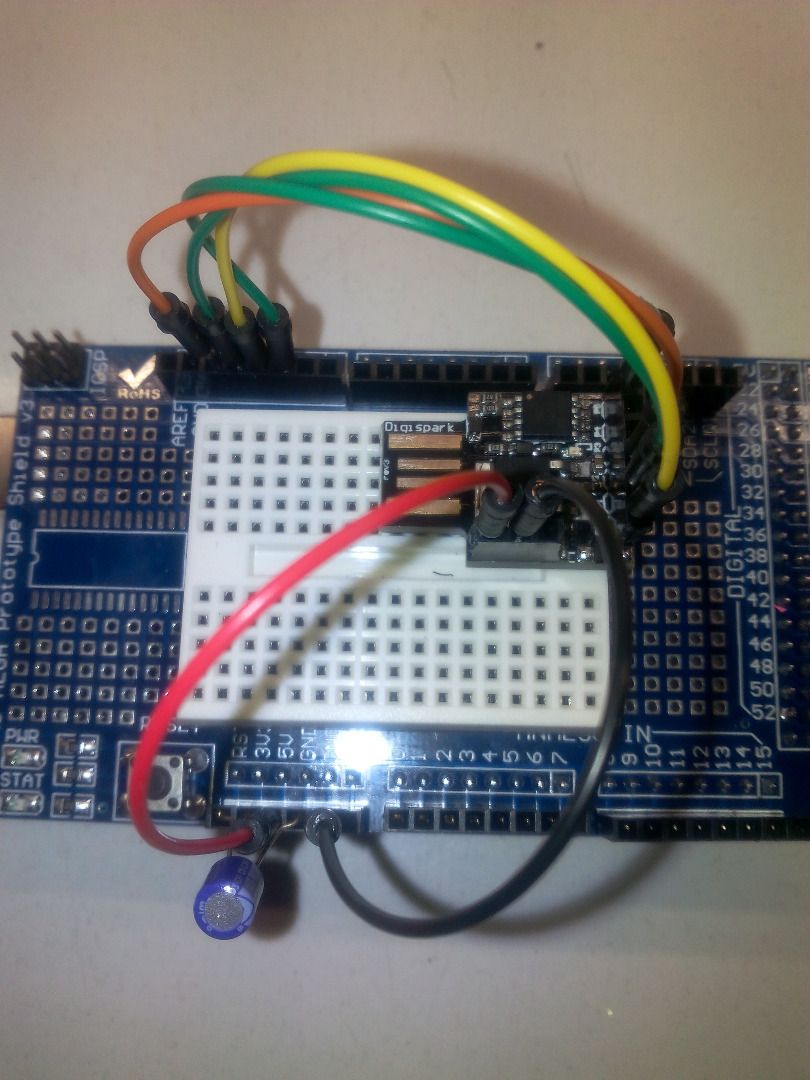

Step 5: Plug in Digispark to Computer
1. Plug in Digispark to the USB port of computer
2. USB device is detected for first time use and prompt you to installing Digispark bootloader.
3. Click on Next button until finish.

Connect a 330ohm resistor & LED to both pin5(Digital 0) and pin6(Digital 1) of ATTINY85. Plug the Digispark to computer,  both LED is start blinking now.

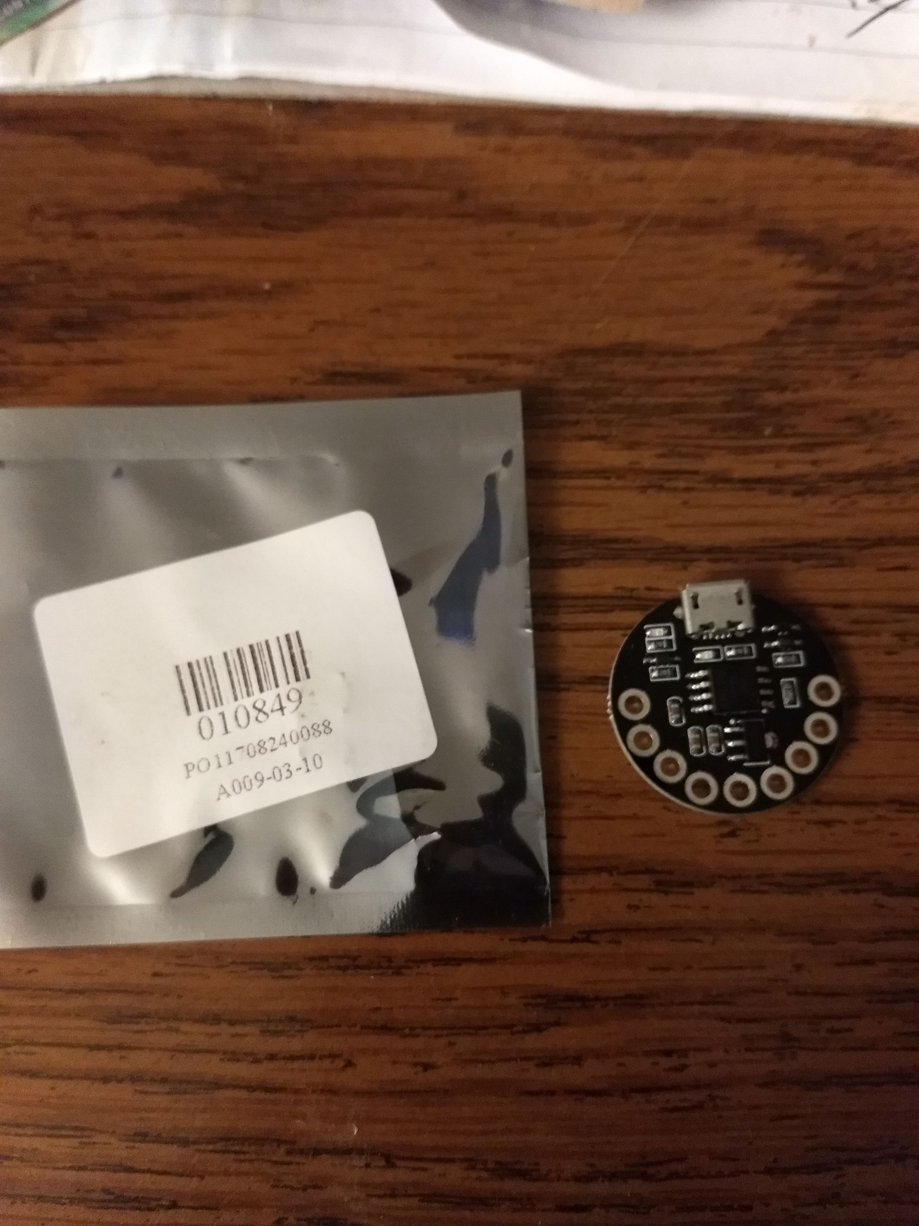

Question 2 years ago

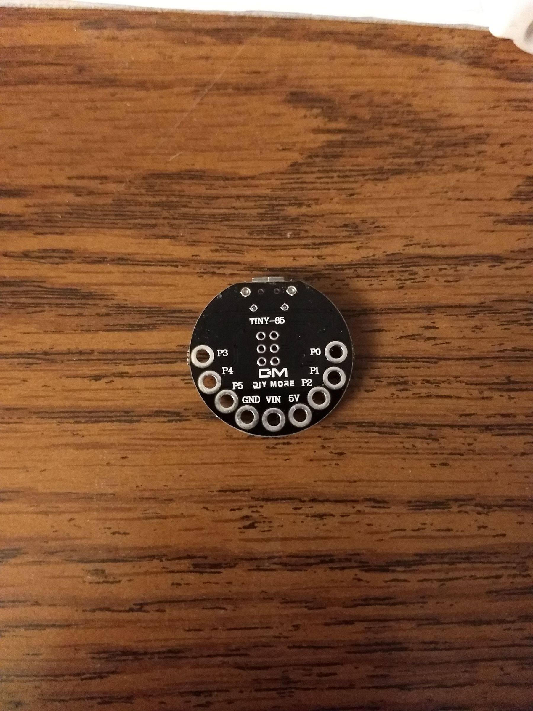

I found a couple of tiny-85 dev boards in my stash but have no idea what to do with them. They have a attiny 85 micro controller and a micro USB interface with six pads labeled 0-5. Would your boot loader and USB driver likely with with this board? It looks like a lilypad but with the USB and without the graphics. It is labeled with a phrase DIY MORE but their web site doesn't have any reference to this product.
