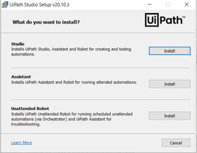

1. UiPath Studio Installation
I followed these steps from the UiPath website to install UiPath Studio; the enterprise edition wasn't necessary for this project since I personalized all my processes.

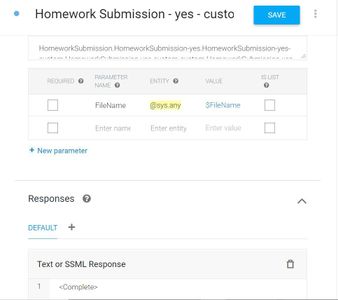

Once all my intents were complete, I needed to figure out how I can process and move input in Dialogflow for each of my custom intents. When I created each custom follow-up intent, I accommodated for the possibility of the chatbot scraping the information that my process needed out of the user's response. Dialogflow made this very conveniently easy as I only needed to highlight the section of the response that contains the desired information for each individual sample training phrase that I created and then assign these values to a new "entity", which is essentially just an argument. The entity that you use to get and store these values from the user can be of a multitude of types, but for most cases you would want to use the "any" type, as it is the most generic*. There is an image of the page that I saw when creating my entities for inputs. How this works
Once I gathered all the information I needed, I just left the final response from the chatbot blank for now, since I would add it in the integration step.
*Note: all your input arguments or "entities" that you scrape in Dialogflow must have the same variable names as the inputs that you created for your process, otherwise the connection will not work.

I now went back to the Dialogflow portal where my chatbot intents were all configured except for the final response, and now I could insert the output from my processes for each intent. After I connected UiPath and Dialogflow, I was able to transfer the output from the process into the chatbot by calling the output variable name in the response enclosed in the "<" and ">" symbols.
For reference, my output from my Homework Submission process is named "Complete" so in Dialogflow, the response field contains the text "".
I did this for each of my processes, making sure everything was spelled correctly and placed correctly because otherwise it won't print out the right output.
