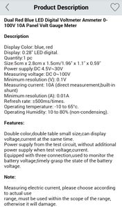

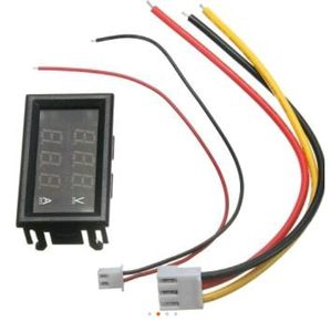

* digital DC voltage and current panel module. able to work from 12v supply and measure upto 100volts DC 10amps. When i received mines it was rated on side sticker as 40v/10a.

I have tried to colour code white wires wires red, green and black marker in pictures. I soldered direct to 3 pins on DMM as space was restricted for female plug.
Use thicker core wire capable of carrying heavy current from digital panel to contact terminals. i used speaker wire.

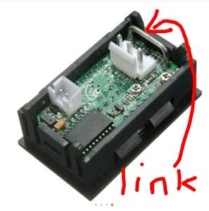

My panel meter was missing an internal current loop link so i had to solder this in order to get a current reading.

The digital display panel requires minimum 4.5v supply, so the internal 12v battery should last a good while.

Display should light up 0.00V/0.00A
Insert test battery between case probes.
Get voltage reading eg 1.34V
Now temporarily press load test button for a few seconds and obtain current reading eg 0.3A. The voltage reading will drop when doing the load test, ignore this.
