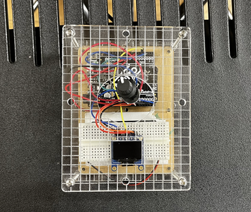

In this tutorial, we'll guide you through the process of creating your own digital notice board for elevators using a Monochrome OLED 0.96" 128x64 OLED Graphic Display with a STEMMA QT connector. This project includes a rotary switch to navigate between different floors, making it a convenient and modern way to convey information in a building's lift.
  • Monochrome OLED 0.96" 128x64 OLED Graphic Display with STEMMA QT
  • Rotary switch
  • Adafruit Metroboard or compatible microcontroller
  • Jumper wires
  • Breadboard
  • Power supply (USB cable or batteries)
  • Enclosure : Acryllic sheets, Nuts & Bolts, Repurposed Dial
Collect all the necessary components mentioned above. Make sure the OLED display has the STEMMA QT connector for easy wiring.

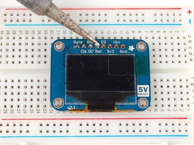

Step 1: Wiring
Connect the components on the breadboard as follows:
OLED Display
  • GND goes to ground
  • Vin goes to 5V
  • Data to I2C SDA (on the Metroboard, this is A4)
  • Clk to I2C SCL (on the Metroboard, this is A5)
  • RST to digital 4
  • Connect the rotary switch to the appropriate pins on the Metroboard/ Arduino Uno. Typically, these are digital input pins.
  • Check the Serial Monitor to identify active switch positions

Step 5: Building an Enclosure
While building the enclosure, we needed to keep in mind the fact that it needed to be mounted. Material Used for the enclosure here are, Quarter-inch acryllic, a repurposed circular dial, nuts and bolts (for mounting) and cut vinyl stickers for indications and markings.
