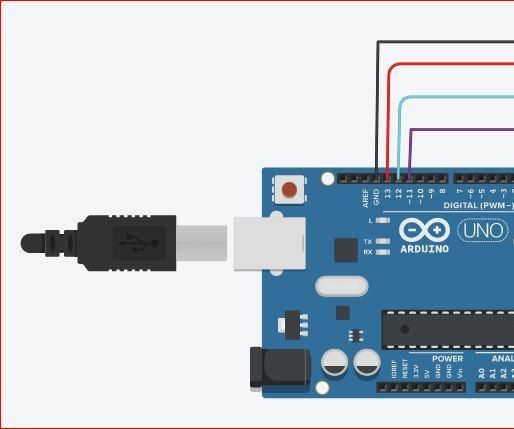

Step 1: Arrange of Arduino,Bread Board and Potentimeter.
Arrange Arduino , Bread Board and Potentiometer as shown in the image

Step 4: Connecting Wires
1. Connect the 5V pin from Arduino Uno to the positive rails of the breadboard
2. Connect the ground (GND) pin from Arduino Uno to the negative rails of the breadboard
3. Place the potentiometer on the breadboard, and connect terminals 1 and 2 of the potentiometer to the positive and negative rails of the breadboard, respectively.
4. Connect the ground (GND) pin of the LCD to the negative rail of the breadboard.
5. Connect the power (VCC) pin of the LCD to the positive rail of the breadboard.
6. Connect the contrast (V0) pin of the LCD to the wiper pin of the potentiometer through the breadboard.
7. Connect the Register Select (RS) pin of the LCD to the digital pin 12 of the Arduino through the breadboard.
8. Connect the Read/Write (RW) pin of the LCD to the negative rail of the breadboard.
9. Connect the Enable (E) pin of the LCD to the digital pin 11 of the Arduino through the breadboard.
10. Data pins DB0 to DB3 of the LCD are not connected to anything because we are using 4-wire mode (only four pins are connected to the Arduino).
11. Data pins DB4 to DB7 of the LCD are connected to the Arduino digital pins 5 to 2, respectively.
12. LED Anode of the LCD is connected to the positive rail of the breadboard through 220 ohm resistor, and LED Cathode of the LCD is connected to the negative rail of the breadboard.
Follow these methods for connecting wires.
