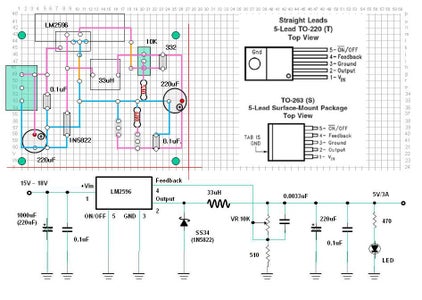

As long and sustained operation is required as 7x24 by this digital clock, less heat producing and efficient LM2596-based switching power supply circuit is utilized instead of LM7805 voltage regulator circuit.
Usually, serial voltage regulator circuits (LM7805) produce quite much heat when the input voltage is quite high such as 15~18V.
Shown LM2596 circuit can support 15~18V input and produce 1.2 ~ 17V adjustable up to 3A power output.
Although a commercial LM2596 step-down voltage regulator breakout board is available, I tried to make a more reliable and sustainable power supply by making my own.
Therefore, more high-quality electrolytic capacitors and a bigger heat sink are used in my power supply circuit.

For the LM2596 switch power supply circuit, the following parts are used.
- LM2596 adjustable switch power supply IC
- IN5822 SCHOTTKY BARRIER diode
- 33uH inductor (more than 3A)
- 220uF x 2 electrolytic capacitor, 0.1uF x 2 ceramic capacitor, 0.003uF film capacitor
- 510ohm, 680ohm resistors
- Power socket (male and female)

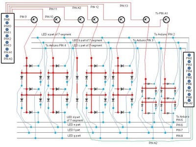

Step 3: Wiring and Soldering 7-segment Display
When you complete wiring and soldering this 7-segment display board, more than 80% of the digital clock is made.
Because this display board is the most complex part of making this digital clock.
As you can see in the schematics and wiring picture above, careful wiring and soldering are required.
To support more convenient wiring and soldering 7 segment data lines (a ~ g LED connection), a tin wire-based data bus is made as you can see in the wiring picture above.
For simplifying the wiring schematics, I depicted only 1 LED for hours and minutes 7-segment display. (But this part consists of 2 LEDs)
As each 7-segment is controlled by one PNP transistor, 7 control lines (PIN9 ~ PIN13, A1, and A3) are connected with the Arduino Uno.
As you can see in the last picture, the 7-segment display board is connected to an Arduino Uno board with DuPont wires.
The power supply lines (Vcc and GND) are not depicted in the wiring diagram above, Vcc (5V) power line from Arduino is connected to all emitter leads of the BD140 PNP transistor.
Step 4: Making LM2596 Switch Power Supply Board
As I mentioned in the step above, a commercial and fixed 5V LM2596 step-down switch power supply break-out module is available.
But I tried to make a more robust and sturdy power supply module by using high-quality capacitors and other components of this circuit.
As shown in the picture above, I need to connect this digital clock to an 18V/1A wall power supply adaptor or 15V switching power supply unit.
The technical specification and functionality of this custom circuit are the same as commercially available break-out board.

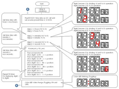

Step 6: Sketch Program Making
To understand the operation of this digital clock, the most difficult part is showing the number string on the 6 digits of the 7-segment display.
Therefore, I recommend reading the following Instructable for showing a number on the common anode 7-segment LED display.
https://www.instructables.com/File-Server-With-Current-Meter/
Getting a timestamp from DS3231 is a simple system call as follows.
- hours = now.hour()
- minutes = now.minute();
- seconds = now.second();
When time data is stored to integer values such as hours, minutes, and seconds, each digit for HH:MM:SS is calculated like below.
- digit1 = (hours/10) % 10; // When assume hours is 12, result become 1
- digit2 = hours % 10; // digit2 becomes 2
- digit3 = (minutes/10) % 10; // When assume hours is 34, result become 3
- digit4 = minutes % 10; // digit4 becomes 4
- digit5 = (seconds/10) % 10; // When assume hours is 56, result become 5
- digit6 = seconds % 10; // digit6 becomes 6
As all digits of the time data (HH:MM:SS) are calculated, then displaying each digit to the intended position like below. (Let's assume present time string is 12:34 56, 12 hours, 34 minutes, and 56 seconds)
- Turn on the transistor #1 (Leftmost position such as Hx : xx xx) and show digit1 (such as 1x : xx xx)
- Turn on the transistor #2 (2nd from Leftmost position such as xH : xx xx) and show digit2 (such as x2 : xx xx)
- Turn on the transistor #3 (3rd from Leftmost position such as xx : Mx xx) and show digit3 (such as xx : 3x xx)
- Turn on the transistor #4 (4th from Leftmost position such as xx : xM xx) and show digit4 (such as xx : x4 xx)
- Turn on the transistor #5 (5th from Leftmost position such as xx : xx Sx) and show digit5 (such as xx : xx 5x)
- Turn on the transistor #6 (rightmost position such as xx : xx xS) and show digit6 (such as xx : xx x6)
Each digit is displayed on the designated position of the 7-segment display and then waits a very short time (delay(1), 1/1000 second).
And when repeating the above display and waiting for actions 50 times, numbers are shown steadily on the 6 digits of the 7-segment display. (It’s a kind of visual illusion like showing a movie with many frames of the photo included in a film roll).
After showing time digits 50 times, colon LEDs are toggling (ON to OFF and OFF to ON).
Therefore, the colon LEDs are blinking by turning on and OFF per each 300ms (1ms x 6 digits display x 50 times).
That’s how this digital clock is operating.

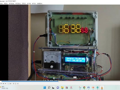

As 72 LEDs (56 yellow and 16 red) are used, I guessed more than 100mA (assuming individual LED is consuming about 10mA, roughly 700mA of current seems required) is flowing to this clock circuit.
But as you can see in the video in the following link, the current flowing to this clock changes from 40mA to 100mA).
https://drive.google.com/file/d/1CeBQwiZC-ydp7stHvsaGcAGftG70bV5w/view?usp=sharing
Although many LEDs are used, only a single digit of the 7-segment display is turned on according to the sketch program explained in the above step.
When assuming all 14 LEDs are turned on (displaying number 8) by the rightmost digit, about 90mA is required.
Each individual LED of the rightmost 7-segment digit display seems to consume less than 10mA.
The 40mA of minimum current level seems required power for turning on the second part of the digit.
As this digit consists of 7 LEDs, the required current level is very low.
Anyway, the digital clock seems correctly operating and very useful in everyday life.
