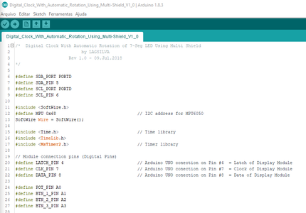

Step 4: Code
The main functions of the code are:
- Reading of accelerometers inclination angles.
- Calculation of the transfer function for the 7-seg LED display (see pictures).
With the angles is possible to detect the spacial position of the clock and decide what routine will be released:
- Front View - Clock Stand Up
- Front View - Clock Upside Down
- Mirror View - Clock Stand Up
- Mirror View - Clock Upside Down
