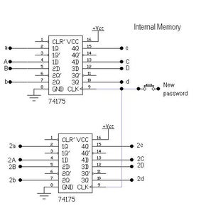

Now… why did i said we need four 74175?
Well to save the password!! While its possible just to set the password with resistors to GND or Vcc, that will make your password static, and impossible to change if you get your lock done in a PCB.
So, with a memory, you can save the password, and change it as many times as you wish.
The inputs will be the outputs of our displays memory, so when a positive pulse reaches their clock, you will be coping whathever numbers are in the displays. (both, the memories and password memories will have the same information). Of course the "new password" pulse will only be avaliable if you already intruduced the correct password and opened the lock.
In all we will have a storage capacity of 2 Bytes or 16 bits!!

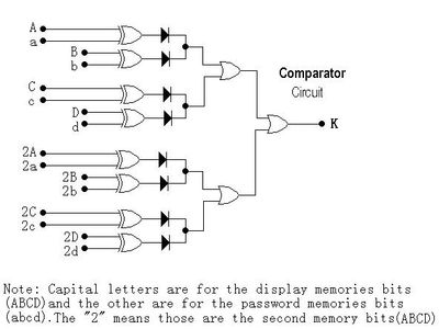

Step 6: Comparing
At this point we have a system thats capable of saving each number we press in one display then the other, and copying that information to the password memories… we are still lacking the essential, the Comparator… one circuit that will compare the two (ABCD) of the display memories with the two (ABCD) of the password memories.. Again, theres already an IC from the TTL family that does all the dirty job, but it wasnt in available in my local electronic shop.
So I built my own.
To understand how i did it lets look at the XOR truth table
 A  a]  X
 0  0]  0
 0  1]  1
 1  0]  1
 1  1]  0
Notice that whenever A and a have the same value, the output is low (0).
So if they are diferent we will have a 1 at the output.
Meaning that with one XOR Gate you can compare 2 bits one of the display memory and the other of the password memory. Based on that i built the following circuit, remember that you can build it your own way, cause there are many ways to get to the same answer here in digital electronics.
This circuit takes in the 8 bits of the display memories ( one bit per XOR, cause the other input should be used with the password memory) and the 8 bits of the password memories ( its a 1 Byte comparator).
And will deliver only one output.
 if and only if the information on both display memories is the same as the information in the password memories, we will have a (0) low output. In other words, if the information on both sets of memories differ, even on 1 bit, the output will be high (1).
