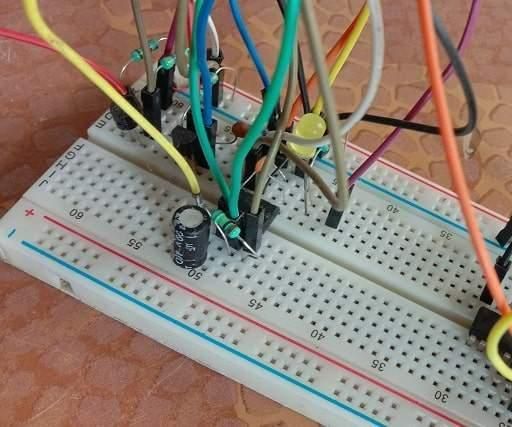

Step 2: Step 2: Create the Circuit
This is the circuit diagram for display decimal counting on every trigger pulse has applied on the clock input of LSB CD4026.
As you can see that in this circuit three CD4026B is cascaded. Carry out pin is connects with clock input of next chip. You can add as many chips as you wish. First chip (U1) drives the display for 1’s place, second chip is for 10’s place and third chip drives the display for 100’s place.
DEI is (Display enable in) kept high to enable the display output. Reset (MR) pins of all chips are individually tied to ground.
You can tie them together and rest the counting form one button or something.
Use common cathode 7-segmetn display. Connect all segment (a…g) pin of CD4026B to segment pins of 7-segment display correctly. Connect common cathode to ground.
On the clock signal you can connect any type of sensor which can give a clock pulse in response to an event. So that you can count how many times that event occurred.
