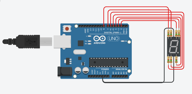

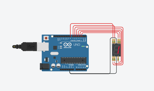

Step 1: Wiring
This step should be fairly simple. For this tutorial, I will be using a cathode common 7-segment display, the reason I tell you this is because some displays are anode common, and could invert the signal of the pin (Eg. HIGH=OFF, LOW=ON). Anyways, onto wiring. Common (for this example) goes on GND (we will do this twice because we have 2 commons on the same slot, different sides), so that means that all of our other pins will go on the digital / analog side. Now, when wiring the output wires, include a 150 Ω resistor. Now, just repeat until you are ready for coding!
Tip: Put your wires (A, B, C...) in order on the pins (A=2, B=3...) it will help when coding!
