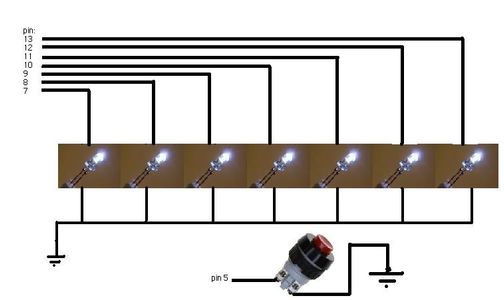

Step 2: Soldering.
Solder a wire to all of the LED's (...)
Now bundle up the - wires so you can connect it to the arduino.
Solder wires to your switch
NOTE:
If you don't have jumper wire ( the stuff you can put into the female header) you can use paperclips.
Just solder a paperclip to the points that will connect to the Arduino.

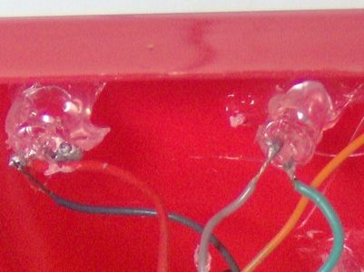

Step 3: Glueing and Cutting.
First off I recommend using a rotary tool and not a knife.
Measure where the arduino power plug will be and mark it with a pencil. Then drill a small hole in the center.
Keep making the hole bigger until the plug (which is connected to the battery) will fit through.

LED positions:
LED 0- Wil be in the middle of the cross and wil be connected to pin 7
LED 1- The upper right corner, pin 13
LED 2- Middle right, pin 12
LED 3- Down right, pin 11
LED 4- Down left, pin 10
LED 5- Middle left, pin 9
LED 6- Upper left, pin 8
Switch- Pick location, pin 5
NOTE: These locations are when the lid is closed!
