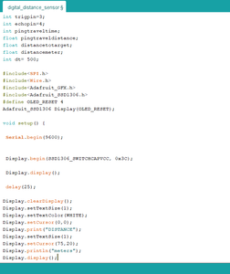

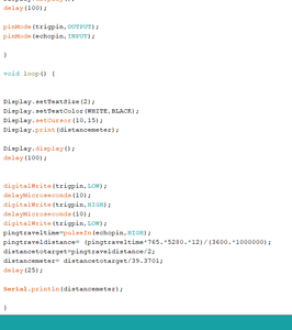

Step 4: Writing and Uploading the Program to the Arduino
This program was written using the Arduino IDE and this is what allows the components to work. The distance is given in SI units which can be changed by altering the variable "distancemeter." The code used in this project will be provided at the end. However, if you want to make modifications to the code, you will need to download a few libraries. In the IDE, click sketch, a drop down will appear and then click include libraries. After this is done, click manage libraries and search for Adafruit GFX library and SSD1306 then download. Be sure to include these libraries if you are making your own code.

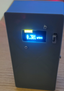

After all of the pins have been put in the correct places and the code has been sent to the Arduino, the project should be fully functional. The laser module should be on and the display should be show numbers that are changing relatively often. At this point add a switch between the 5v output from the Arduino and the vcc pins of the modules. This allows you to turn off the circuit.
Note: The switch only turns off the functions to the modules. The Arduino will still be on, so the battery will drain if not disconnected. Also, once the display has been switched off, it cannot be turned on until the Arduino is reset button is pressed or the 5v pin is disconnected and reconnected to it.

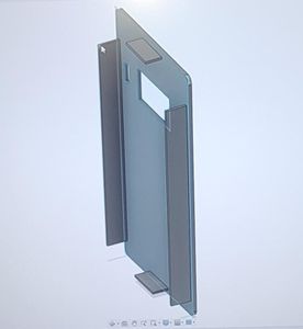

Step 6: (Optional Step) Access to a 3d Printer Required- Build Assembly
The files for 3D printing these pieces are provided below. Once printing is finished, make a small 6mm hole in the front of the case right above the distance sensor holes. This is where the laser module will be. Next, put the 3d printed pieces together and make a hole on both sides of the long face where the protrusions are. This will be for the screws to keep the cover on the case. Finally, align the display with the rectangular cutout on the back and make 2 diagonal screw holes for the display to attach to the cover.

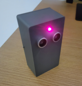

Step 7: Assembly
Put the ultra sonic sensor into the two large holes. Then fit the laser into the smaller hole that you made above the two larger holes. Put the Arduino in the case along with the battery and battery connector. Then, screw the display into its place on the cover. All that is left to do is, screw the cover onto the front case and the build is completed.
Step 8: Project Complete
The digital distance measuring device is now complete. Point it at a nearby wall and see what the measurements are displayed.
