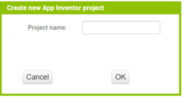

Step 2: Name the Project
Give a suitable name for your Project

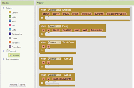

Step 8: Get a Canvas.Dragged Event Block
  • from the Blocks, click on Canvas1.
  • from the drawer, pull out when Canvas1.Dragged event.
Step 9: Get a Canvas.DrawLine Call Block
In the Canvas1 drawer, pull out call Canvas1.DrawLine method block.
Step 10: Use the Get and Set Blocks From the Dragged Block to Fill in the Values for the Draw Line Block.
Mouse over the parameters of the Canvas1.Dragged block to pull out the get blocks (prevX, prevY) and (currentX, currentY)that you need.
(Mouse over them, don't click on them.)
