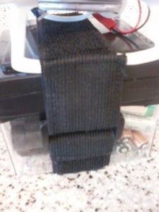

2. Weight greater than anticipated thrust of drone (3 / 4 times drone weight should be enough - used 16 Oz)
3. Strap (wide is better than narrow to prevent tilting)

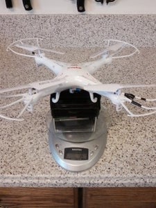

5. A Drone - (drone weight was 3 1/2 Oz - thrust was 4 3/4 Oz - 150% ratio @ 100% power)
To test thrust
1.Secure drone to weight

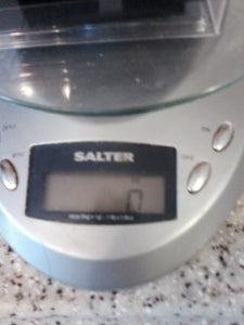

2. Place on scale
3. Turn on scale - should read zero (0 Oz, Kg. etc.)
4. Activate drone
5. Measure thrust as negative weight at selected power setting
