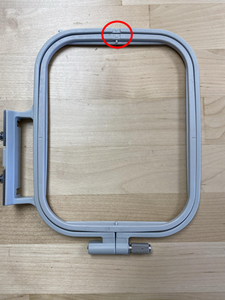

Start by locating your embroidery hoop. Note the triangles on the inner and outer pieces. These will need to be aligned with each other in the next step.

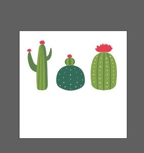

First, I created a simple design in adobe illustrator. I saved my design as a .jpg and opened it in SewArt 64. Next, I used the digitizing tool in SewArt to convert my file to stitches. Lastly, I saved my file from Sewart to the desktop.

After digitizing my file, I save it. A very important step is to check the size of your file. If your file is over 3.5 x 3.5” it needs to be scaled down or it will not send to the embroidery machine. You can quickly size down a file by using the scaling factor to type in a decimal. In this case, I was extra careful and scaled my project by .8 which made the design 2.83 x 2.83”. I will be able to scale this design larger on the machine, but I want to make super sure that it will load correctly on the machine.

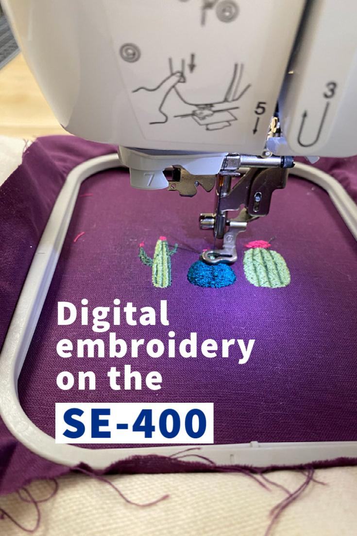

This is how my design came out, note how some of the small details in the design did not come through on the embroidery. I still really liked the design, and so I added two more copies above and below in varied colors. I did this by using the layout feature of the machine which can be found under the icon ‘adjust’.
