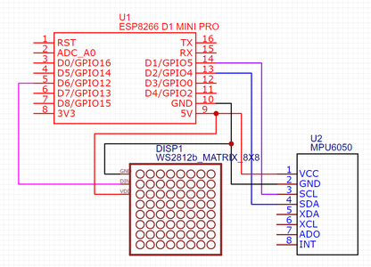

See above for circuit schematic and parts placement on the 3d printed underside_lid piece.
Secure the MPU6050 with the M2x6 screw, and slide the ESP8266 into the slots. Hot glue may be used to hold down the ESP8266 a bit firmer, but once the led matrix is on and the underside_lid is popped into the base, this part will not move.
When soldering the wires to the MPU6050 and the ESP8266, have the wires come out the underside of the boards. There is a gap built in to allow the wires to go through. If they are wired on top, the led matrix won't have enough space.
Make sure the led matrix wires line up with the gap in the underside_lid that allows the wires to go through without lifting the matrix. The matrix should sit flat on the rails of the underside_lid.
Once the parts are soldered and positioned, test the circuits by plugging it in. Also test the gyro by turning the piece upside down to change the color pallet.
Once the parts are soldered, positioned and tested, slide the underside_lid up into the base piece. Line up the oval opening with the usb port of the ESP8266, then push slightly up into the base. It shouldn't need to be forced, if it is too hard to push, check the parts arrangement and make sure nothing is in the way. You should hear a few clicks when the underside goes into the base correctly.

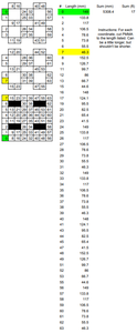

Next start cutting up the PMMA. I recommend cutting as you go. The lengths are not exact, but slightly longer than needed works best. When the pieces are too short they will not have tension on them and they will fall out. The spreadsheet image above lists out approximations for the lengths of each row and how they should be plugged in. I have highlighted a couple to get started. For reference, the green 0 at the back corner of the grid lines up with the green zero at the top left of the first digit. The yellow 7 at the front of the grid, closest to the face, aligns with the bottom right of the last digit. And so on.

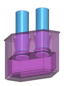

When inserting the PMMA into the lens pieces, push the strand in but don't force it all the way. It should "catch" about half way through the piece, and should be slightly difficult to pull back out when tugged.
Start with the bottom, the row closest to the face. And work your way up/out.
