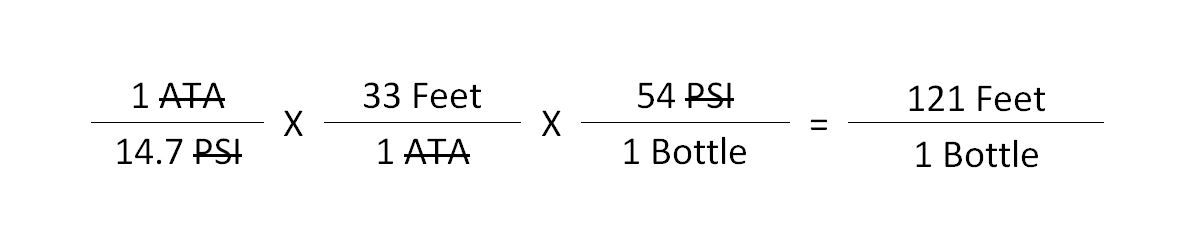

Step 10: Test Soda Pressure
I was really surprised at the consistent pressure of the 3 bottles that I tested. They were all within one PSI from each other. Since the average internal pressure of the soda was 54 PSI, these bottles (not necessarily the Instamorph cap) should be able to withstand the pressure all the way down to 121 feet underwater at sea level.
The deepest I ended up taking them was 70 feet. There's not usually a lot of coral much deeper than that, and most divers are only certified for 60 feet anyway.
