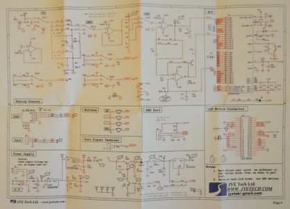

Over time I ordered several kits/development boards/modules from various sources, this is the first that comes with printed schematic, assembly manual and user manual. Therefore first impression was very good.

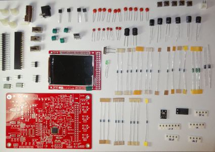

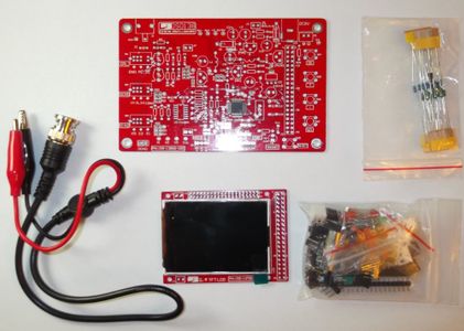

Step 1: Kit Overview
Here I put some pictures to see better what it is about.

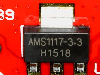

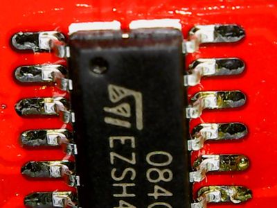

The kit has already soldered STM32F103C8T6 microcontroller. Other SMD components must be soldered by us.
Another mention: Microcontroller is already programmed with firmware, so no need to flash after assembling.
I chose to follow the steps in the documentation.
Let's start.

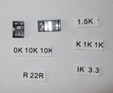

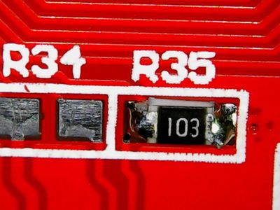

Step 2: SMD Components
This is the most difficult part. Soldering SMD components by hand it is not easy, but can be done carefully.
There is a documentation page specially for this step. It was very useful for me.
Also, I think it is best to unpack one component at a time. Especially for SMD resistors.
And do not sneeze toward desk! :)

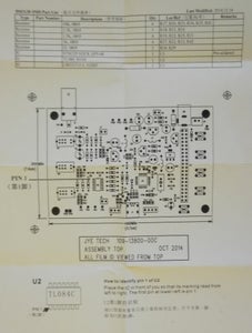

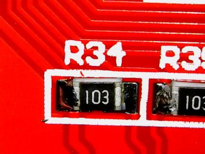

Step 3: Resistors
Things start to be more easy. But there's a catch. It's easy to make mistakes with these resistors (color-coded).
You must carefully identify each resistor(and measure with a multimeter/ohmeter); some values are mirrored versions(or very similar) of other values.

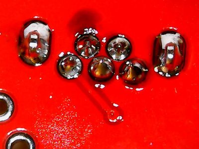

Step 7: USB Socket
USB socket is not in use with current firmware (maybe someday we will try to make our own firmware to use this port).
It is good to check we did correct soldering, pins are very close.

Step 13: Regulators
  • U4 = 79L05
  • U5 = 78L05

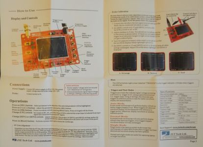

Step 20: Slide Switches
  • SW1 = Coupling selection : GND - AC - DC
  • SW2 = Sensitivity selection 1: 1V - 0.1V - 10mV
  • SW3 = Sensitivity selection 2: X5 - X2 - X1

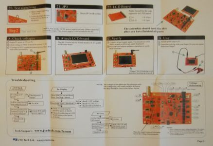

Step 24: Final Check
At this stage all the components are mounted. There is another step: Short JP3 with solder.
After checking voltages in test points (according to the manual), we can short JP4 with solder permanently.
Step 25: Done.
Everything is ok... DSO138 works as it should.

Power Supply is also interesting. (how to obtain +5V and -5V for TL084)
Analog Chanel block illustrate how process an analog signal for digitizing.
