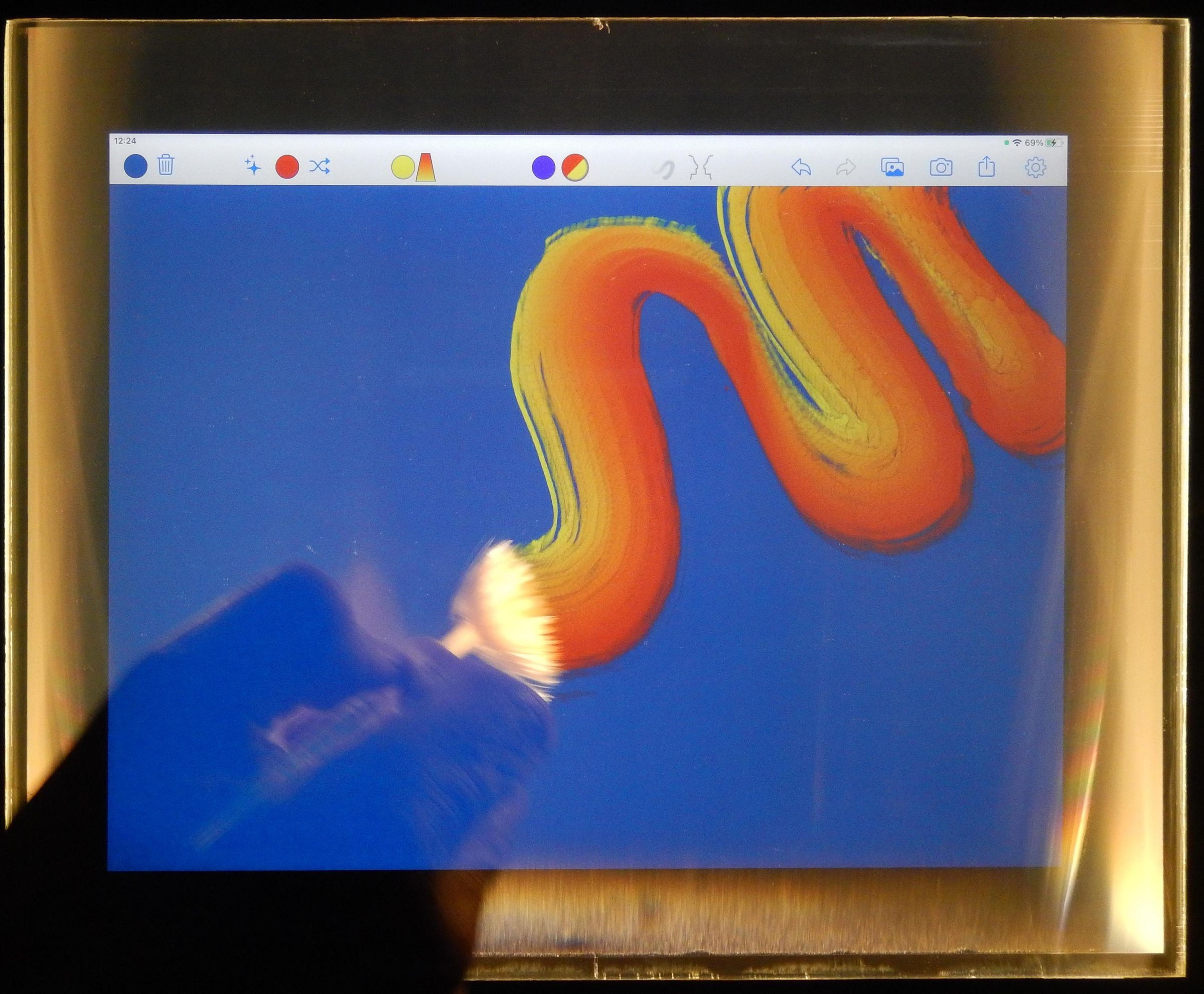

Introduction: Digital Painting With Real Brushes: Light Strokes for IPad
Digital painting apps provide some amazing simulated brushes, but if you miss the expressiveness of painting with real brushes and other physical tools, then this Instructable is for you. It shows how to build the Light Strokes hardware that enables digital painting on the iPad using actual brushes, sponges, rags, or almost anything you'd care to paint with. You can even do digital finger painting. The hardware works in combination with the Light Strokes app, available for free from the App Store. You can see it in action on prototype hardware in the first video.
Light Strokes uses an optical effect you may have noticed when looking down through a glass of water and seeing just your fingertips against the side of the glass. Everywhere else, the background is seen by total internal reflection (TIR). Instead of a glass of water, here we use a Fresnel prism, consisting of thousands of tiny facets. The iPad's camera is placed where it can only see the parts of fingers, brushes, or other tools that are in optical contact with the top of that prism, the painting surface. Wetting the tools helps to eliminate the layer of air needed for TIR. As you move the tools, the Light Strokes app processes the camera's images of the contact areas into painted strokes, with your choice of colors and effects.

Paint
Now you're finally ready to paint! Place the unit on a low table (e.g. 20-24" tall) that puts the painting surface at a comfortable height. On the settings panel select Paint, and set the ISO just high enough that you can easily paint in the full paint color with a wet white brush. Set the Threshold just high enough that the screen clears completely when you touch the trashcan icon. You may also need to clean the glass and turn off nearby or overhead lights to have that happen. If a bright part of the enclosure prevents clearing at an edge, you can adjust the X and/or Y offsets to hide it, since the center of the painting area doesn't need to be at the exact center of the glass. For off-white tools and finger painting, you may need raise the ISO and the Threshold.
If you get lost with unusual combinations of settings, you can always revert back to the Default Settings. But before doing that, jot down your values for the X and Y offsets, scales, and Keystone, so that you can restore them without having to align the video again.
Besides brushes and other traditional painting tools, you can paint with anything that's light-colored and wet. Feel free to experiment with milk, cooked pasta, cut vegetables, plastic utensils, or anything else that won't scratch the painting surface. If you want to rest your hand on the surface while painting, put a piece of black plastic or cloth under it. You can add a couple drops of a low-foaming surfactant (Veggie Wash or Edwal LFN) to the water, to make water beads less visible. You can also clean off excess water after swiping right on the iPad to temporarily freeze painting, then swipe left to resume.
