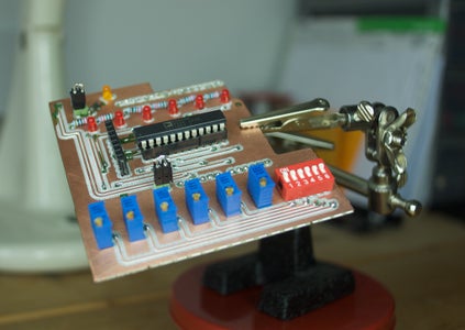

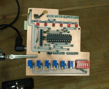

Step 1: The Circuit
As you can see in the circuit schematics, it is divided in three parts:
1. Test LEDs and Digital Potentiometers external connector
Every digital potentiometer output is accessible on a pin of the JP1 connector (named DigiPot Ext Connections) the same output signals are connected to six test LEDs for testing and development purpose. To avoid interferences, the jumper JP2 (named Test Led Jumper) should be disconnected to exclude the LEDs from the circuit while working together with a controlled circuit.
The AD5206 is powered by the Arduino 5VCC but accept as potentiometers reference a variable voltage between about 1,5 and 5 V. To use a different voltage than Arduino VCC the first two pins of the JP1 connector should be used to power the AD5206 potentiometers and the jumper JP3 (named Internal Power Jumper) should be disconnected, to exclude the Arduino internal voltage reference.
2. The AD5206 circuitry
The central part of the schematics includes the connections to the Arduino board of the AD5206. I have added the LED7 to monitor the SPI clock signal when the micro controller sends data to the device.
Note: the digital potentiometers of the AD5206 are internally latched: this means that when the circuit is powered, the device retains the last setting sent.
3. Test and setting trimmers
To be used for testing purposes or to preset independent values on every digital potentiometers, I have added 6 trimmers connected to the six analog input of the Arduino. In the case you need one or more analog ports free for your projects the trimmers can be disabled with the DIP Switch S2.
WARNING!!!
When connecting the Arduino shield to an external circuit board through the signals on the connector JP1, you must put the GND signal (JP1-pin1) in common with the other circuit.
